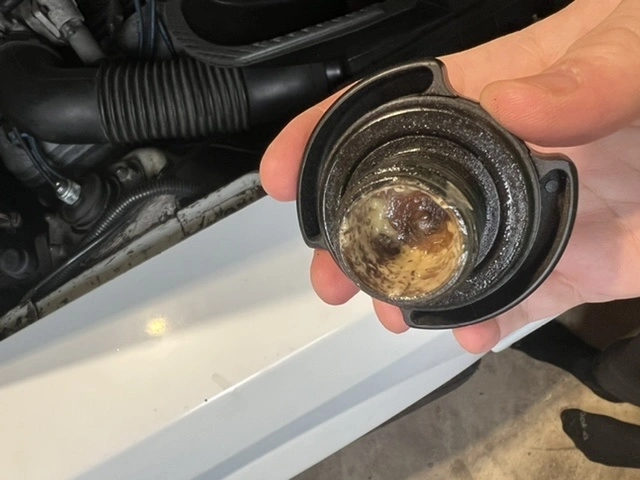

Seems like it didn’t do the trick, unfortunately. Just checked under the car after running some errands and there is oil still steadily dripping from around where the transmission meets the engine and oil on the x pipe is creating a bit of smoke along with a burning smell.
Also, when I checked the oil before turning the car on today, it was alarmingly low. I’m not sure if this was due to the car leaking oil on the drive home or if the shop just didn’t put enough oil back in after replacing the RMS (or maybe both).
There was some gunk in the oil filler cap area when I added oil. I understand (based on some quick searches) that this could be oil-water emulsion that can be a result of driving the car short distances in cold winter conditions(?). I plan to check the coolant level when the car cools down.
A2FFACD8-18AA-4B40-897C-DB80D849954A.webp 53AEBFA7-B4A4-4711-8A45-68B52D529985.webp
I’m trying not to assume the worst about all of the above. Other than the burning/smoke from the oil leaking, the car seems to be running OK.

You better change your oil, and get a good look at it. I'm no master mechanic, but that emulsion would concern me. It's your car, and I'm nervous about it. I have read too many posts with water in the oil. The rear main seal thing is depressing. I did mine when I did a clutch, and it started dripping right away. Same thing with the burning smell and clutch slipping at times.
I added new oil when I saw it was really low. I didn’t see any emulsion on the dipstick (just checked again). There’s no gunk or film in the oil that’s dripped into the catch pan since I got back from running errands. Still seems a little too warm to check the coolant but will do that and check oil again in an hour or two.
Don't stress the gunk on the bottom of the oil fill cap, now the rms still leaking would drive me bat sh#t. I don't remember confirmation but the bolt holes for the flywheel are open to the oil pan, can anyone confirm?

In cold weather it's like condensation. Normal from sitting in the cold after being hot.

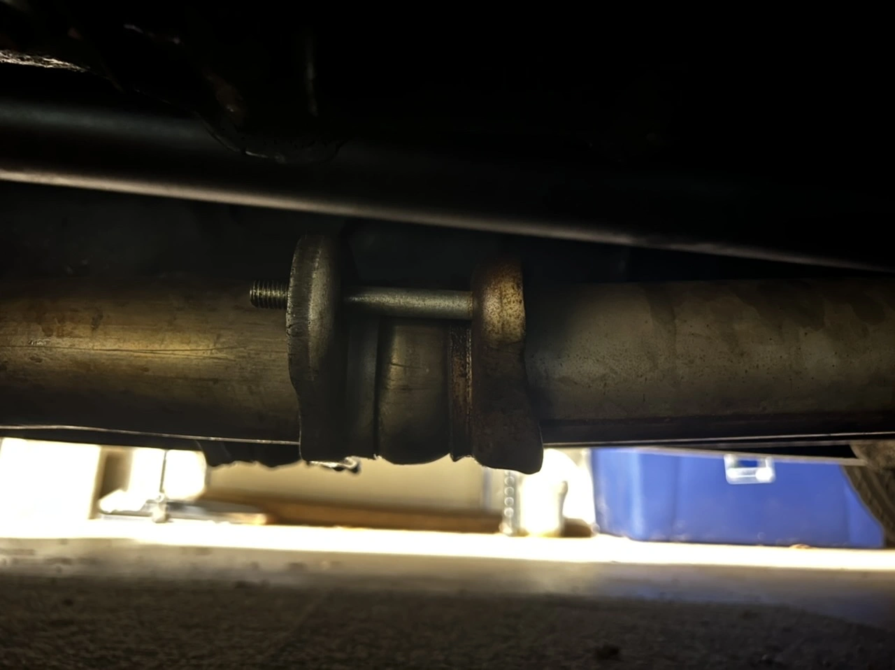

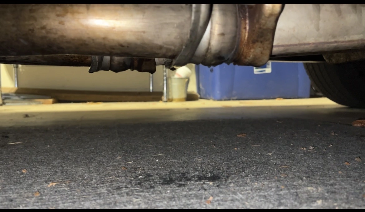

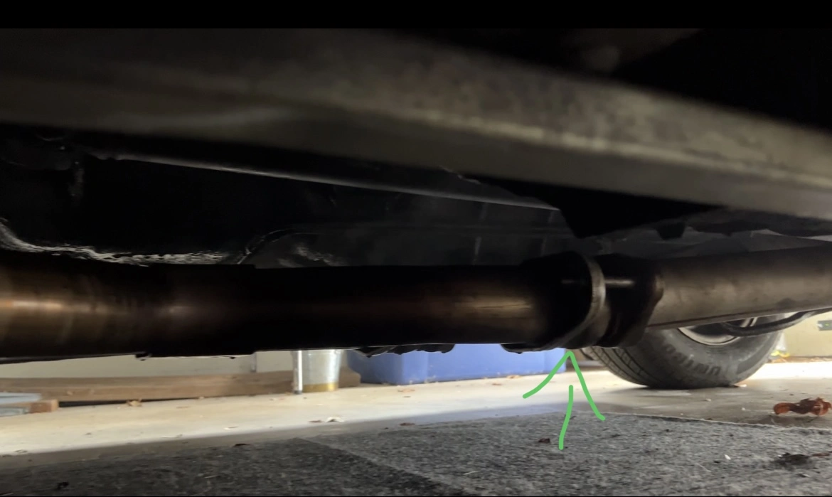

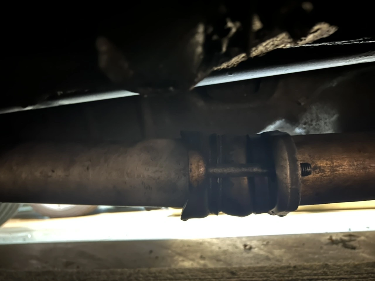

Here’s a couple more pics of where the exhaust is leaking (driver side). In the first pic, which is a screenshot from a recording, you can see fluid coming out.
The passenger side didn’t appear to be leaking at all but once I get the car up on jack stands, I will check the hardware on both sides.
Oil level was still fine but I haven’t driven the car. Just turned it on and let it run for a little while a couple of times. Will include video clips from under the car in my next vlog.
Snugging up the bolts should take care of that leak.
Yeah, that’s my thought after looking more closely. I’m hoping that will at least get the exhaust leak sorted out. Thanks.
It might be slightly warmer (emphasis on slightly) on Sunday so I might try to make some time then.

I made a half a$$ed attempt at tightening the exhaust hardware to fix the leak but it didn’t do the trick. Will try again when it’s a little bit warmer out. More in my latest Vlog here:

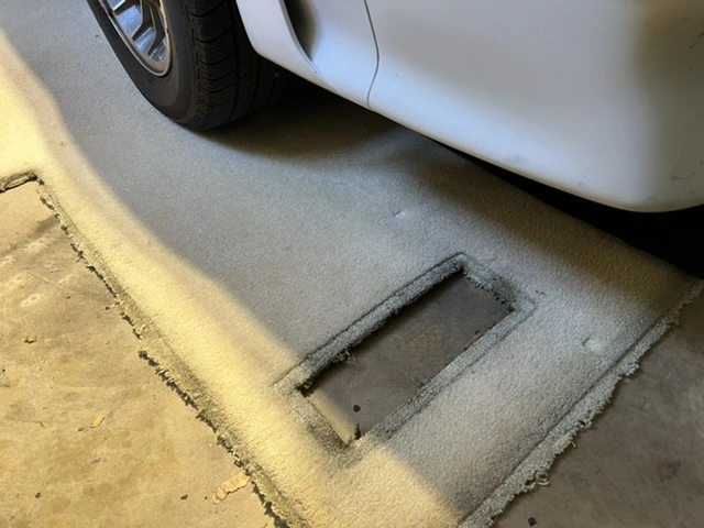

My latest addition to the garage is this makeshift insulation - leftover carpet from having hardwood floors installed in part of the house. I don’t think it will be super warm but hopefully at least more comfortable than the concrete until I can figure out a longer term solution.
Not sure if anyone else picked this up while it was on Blipshift but here’s my latest addition to the t-shirt collection:
View: https://youtu.be/b8Q191xwbfY
One thing I think I forgot to mention in the video is that after driving the car (for over 20 minutes this time), I didn’t see any more of that gunk in the engine oil filler neck. I was also happy to see that the car didn’t seem to lose a ton of oil during that drive.
That will definitely help if you’re laying on the ground at all for any work. I have a strip in between the cars, and laying on that is much better than the bare concrete!!

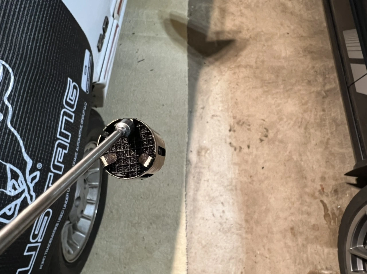

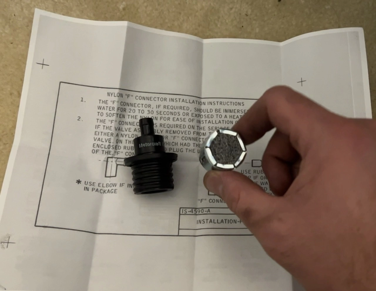

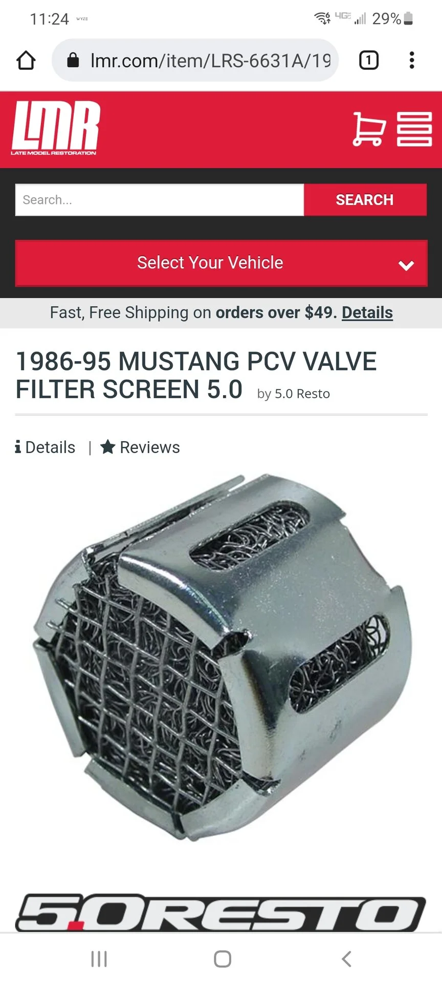

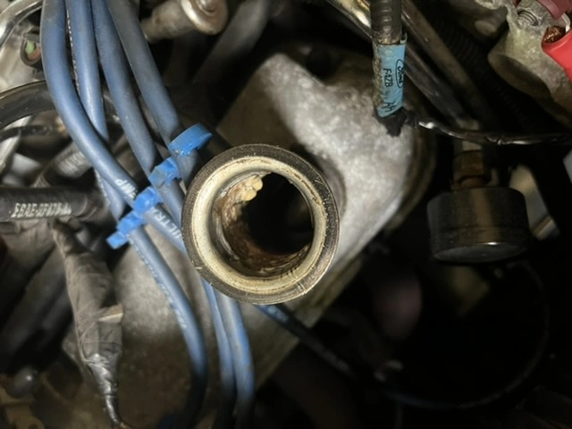

So I finally got behind the intake manifold and saw that the PCV valve was super loose. It seemed like it was still in the hose but was disconnected completely from the grommet and the grommet itself came out really easily. I was also able to remove the screen pretty easily with a magnet:
5B688685-3875-42EB-8E36-1342C85C5FAE.webp 1479E0C7-3386-44A4-AD81-F47D77E633A1.webp
I replaced the screen, grommet, and PCV valve and everything new seemed to fit pretty decently.
It was pretty late when I finished it so I didn’t start the car yet but will do that today and see how the oil leak situation is looking. :) I didn’t take a ton of pics but recorded some of that process for my next video.
