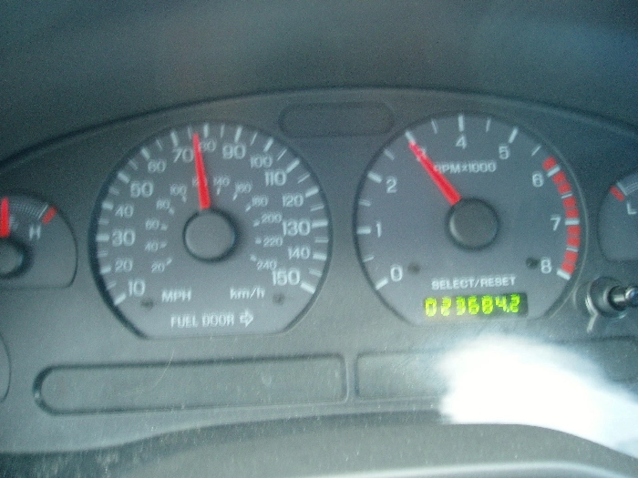

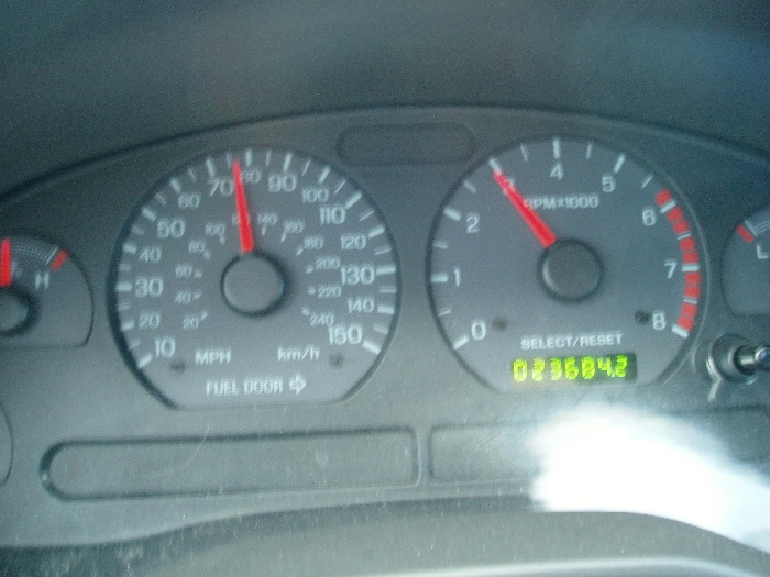

BlackMach2 said:
I figure I've increased my rpms at 70 mph by only 250 rpm or so since installing my 4.10's. Now I spin at about 2700 rpm at 70 mph in overdrive.
Auto with 4.10's
