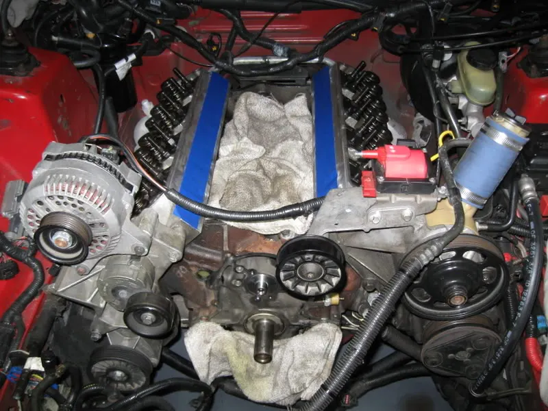

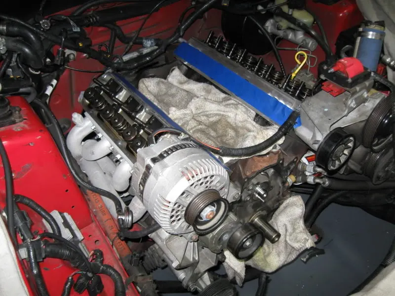

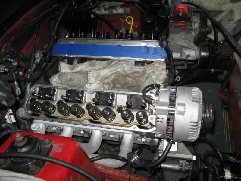

Heres how it looked this afternoon. New cam has a home.

Looks good. why didn't they just remove the alternator???? 2 bolts hold it on........

Didn't need to

That is a wicked alt. bracket...do you happen to know what it is off of other than a 95 cobra R?
I dont think us mere 302 guys can do a cam swap without removing the brackets...I am really jelous of that. LUCKY you can do it that way.
only for the 95R , its actually a prototype bracket but If its not the same as what the put on the R its really close. This car has a lot of prototype stuff used on the R. The RR Hood is 1 of 7 prototype hoods, the ECU Is a prototype R computer.
