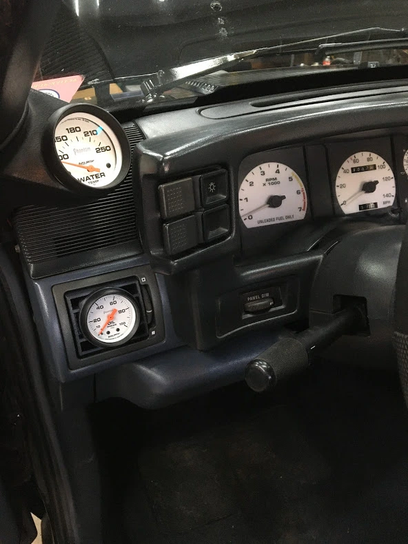

While it's not above the radio or temp gauge, I have used the vent's to house gauges. The new vent is 3D printed and can be had for 25$ on ebay. They do have straight and angled versions for above the radio. I plan to use the angled version to house a wideband eventually.
I wish there was one digital guage that could do multiple things, like display oil pressure, water temp, volts, etc. I really would like to add some gauges to my car, but don't want to clutter up the interior with guage pods. I could do find with 1 or 2 on the A-pillar, like a Air/fuel and then a multi-use gauge. Does Autometer make such a thing?
Not that I know of.. but they should! I had a bullydog gt tuner in a truck once.. it was a small screen and I could assign whichever read outs I wanted. Very useful and similar to Holleys small monitor with their standalone systems
I went on a rampage looking for the same thing. Some of the newer stand alone displays have it, and I found some questionable Chinese products out there. Just doesn't help with the Autometer Pro-comp junk I already have in it.
The vent gauge looks great. I'm trying not to do another pillar set-up, but wished that autometer had a dual water temp/oil pressure gauge that would allow me to add just a single.

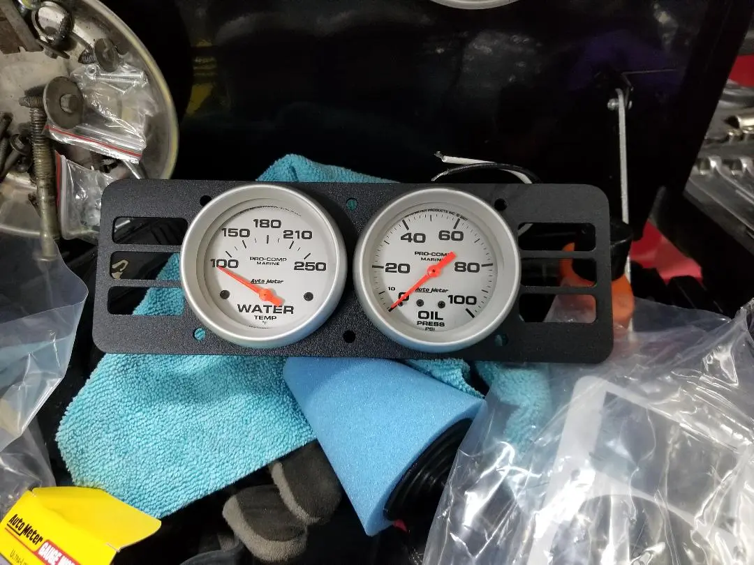

So I ordered the gauges. Just figured they are a heck of a lot cheaper than another motor, or even another turbo. So I get them in, and they're both labeled "Marine".......ok, they look the same as the others, not a worry. Then I open them up and wander how bad the economy is that Autometer couldn't include the water temp sender, or line to plumb the oil pressure. Guess these are not going in today as I'll be tracking down a short sweep sender from AM.

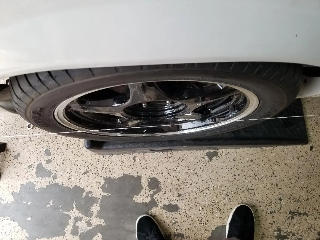

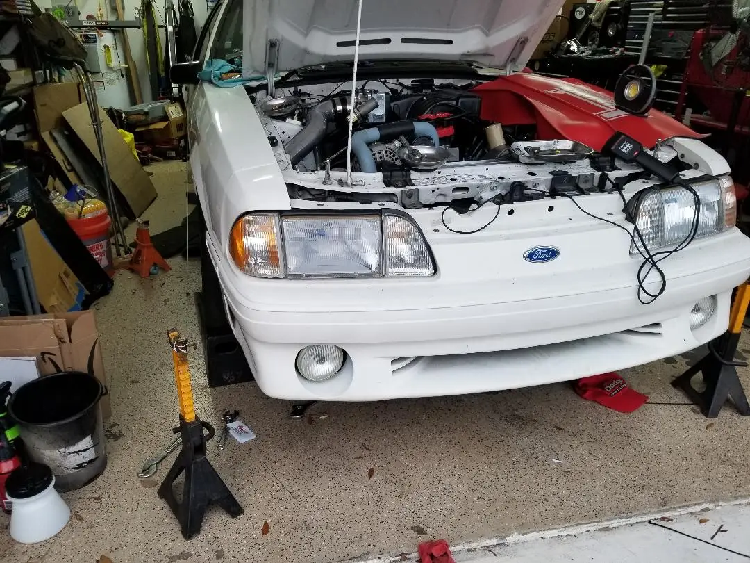

Got some work done today. Checked the alignment layout and started adjusting. If you haven't seen this before it's basically creating a "U" around your rear tires, then extending it past the fronts, while ensuring that you are barely touching the front of our rear tires with the string.
What you should end up with is a very basic way to measure the squareness of your front wheels via front/rear measurements from the string.
In my case, this just helped to make the car "pushable" so I can get it out of the garage and will keep me from destroying the front tires when I take it to a professional for alignment.

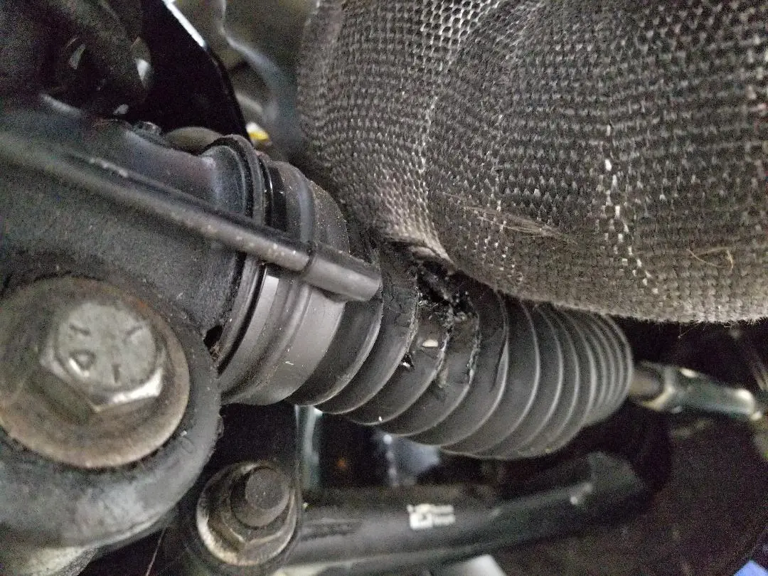

While adjusting underneath the car I found a couple of things that concerned me.
My bellows on the rack has been getting way to hot via the crossover pipe for the turbo. I wrapped it with heat wrap, but will likely try to figure something else out. Another thing I found while pulling myself in and out was that the intercooler mount is just flimsy enough to allow it to vibrate into the radiator support. When you do it by hand it makes this tinging noise much like the one that was making me pucker up with the first few start-ups. Now I need to figure out a good way to place my temperature sender in the engine, and a good way to route my oil line for the pressure gauge.
