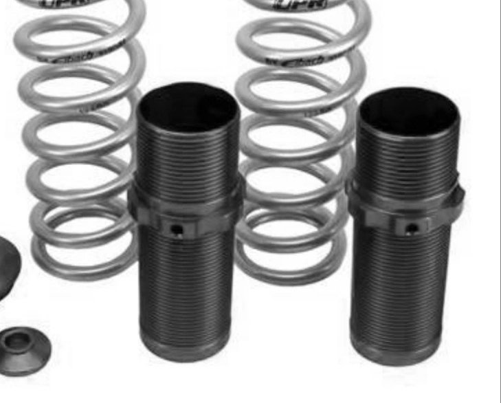

This is the upr adjuster with rounded edges....

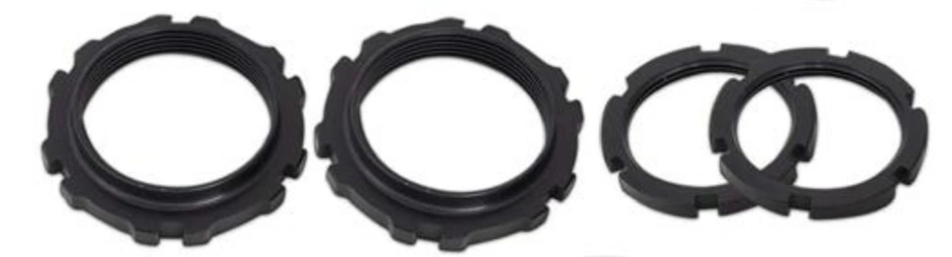

This is the Strange ones with squared edges for the tool to grab.
The spanner wrench I ordered fits right in the notch on the Strange coilovers. I didn't have to use it though. Adjustments were easy by hand. Y'all have me double guessing my use of antiseize though.
The UPR uses a pin spanner and Strange a hook spanner.If using the right diameter pin spanner these are easier to use as the spanner wrench is held more securely with less chance of the tool slipping off.The slotted adj. collar seems to be more common.
