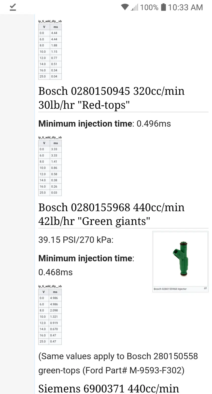

Yea ill be using 30lb cobra injectors.. I kno i gotta set the req fuel... But go figure we didnt cover setting dead times in the class lmfao and that thought never even crossed my mind that id have to change injector dead times. I guess i gotta do alittle research on 30lb injector dead times..

I probably have them in my spreadsheets, what injectors are they?

give them a try, I do not have any good information on the red top injectors. When i cant find the full break point and slopes I refer to eectuning for them.
use .2 for your voltage offset

So i only enter one number in the injector deadtime section in tunerstudios? The ms at 13.2v and that number would be .460 from the chart and .2 for the battery voltage correction.

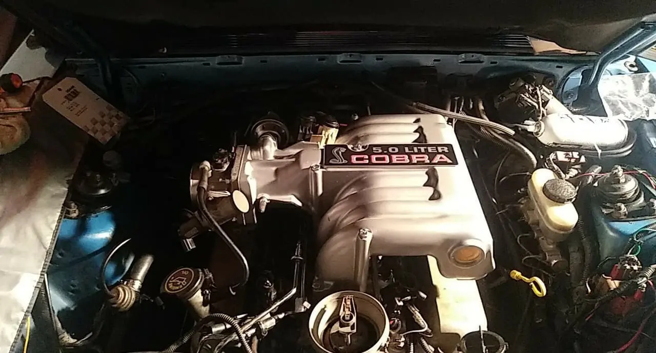

oh and another thing.... am i gonna have to mess with or change anything else on my tune for this? like adjust my ve table. maybe lower it or whatever.. Im firing up my car tomorrow cause its all built and ready.. heres a few pics for your viewing pleasure LOL..

The TFI controls cranking, the grey ones are 'push to start' so when they get a 12v cranking signal they command 10* this is outside the control of the MS.
Looks to me like you are 8* advanced from your description.
