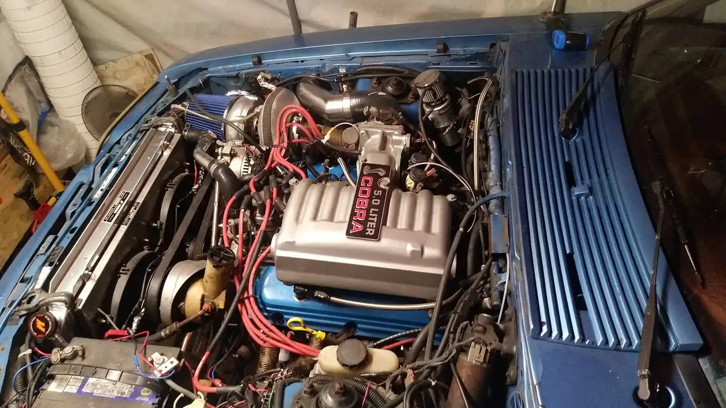

well i figured its been awhile since my last update... so i figured why not do another one..... sooooo i did a thing.. haha finally added my turbo to my car.. and im totally in love with it considering ive literally just finished building it and did my first ride tonight which was a full success,,, No boost tho. but god dam i cant wait to hit that sweet sweet boost when i feel im ready and the tunes ready.... tune and first drive datalog attached for your viewing pleasure.. and yes during the end of my datalog it didnt come into closed loop so i already fixed that.. just figured id post for some giggles. and possibly advice if needed... so enjoy and im finally happy to be apart of the boosted 5.0 club.... happy trails

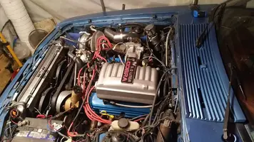

Could you describe how you modified your stock cover for a/n fittings?
sure man.. i used my step drill bit and drilled the holes to fit the an fitting. then i got a 8an fuel bulkhead fitting that has a fuel safe teflon washer. has a nut that seals on the inside of the covers. i tossed some teflon tape and red loctite to keep it tight.. was pretty simple.. i will say one thing tho. if using stock covers like i did make sure to triple measure where your gona land with the rockers and stuff.. not alot of room for error the higher up the cover you go. i stayed low because im using trickflow rockers and they taper down, left me a good amount between rockers .
