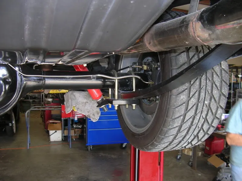

Anyway, I have not had any problem with fraying or wheel hop and I think my 482 FE makes "decent HP". I do have staggered shocks, so that probably helps with the wheel hop.
Definitely recommended.
