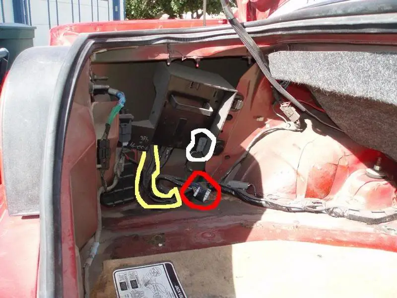

How do you know if you have the module?
look in the trunk on drivers side and remove insulation see picture below....ok the module is located behind the plastic box in the picture but to test if you have the module and see if its working properly turn your ignition on and usa paper clip or wire and make a connection to the two pins within the grey connector circled in white and the locks should cycle to lock then unlock position you will be able to hear this from the trunk area easily...this would mean the module is installed and in good shape....

well the locks dont lock then unlock the module clicks then nothing so I guess its bad.
