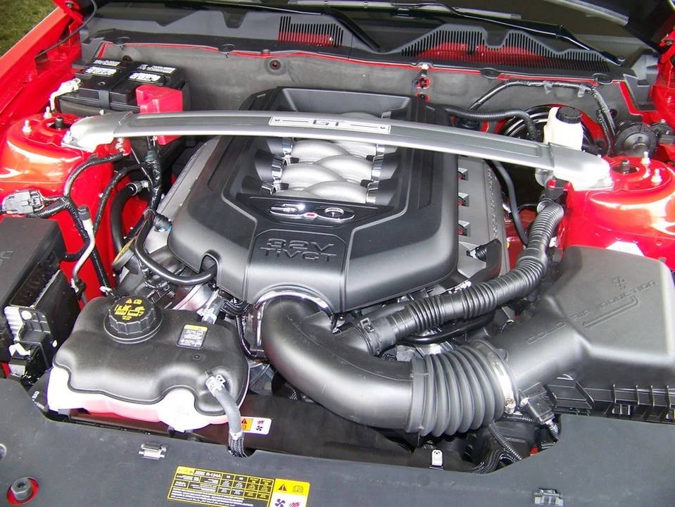

I'm SERIOUSLY considering that swap myself. The engine, hydroboost setup, computer and wire harness will run around $8,500. I'll still need a fuel system and accessories though too. It seems like a lot but the car should prove to be extremely streetable and up the cool factor by 10! I figure I can offset nearly all of that cost by selling my current setup and turbo kit. I was dead set on this swap until I drove the car to Carlisle as that drive reminded me of how streetable and fast my car is now.
