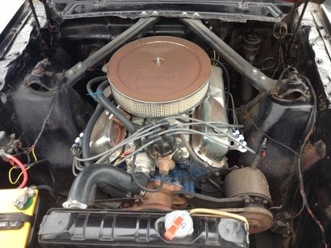

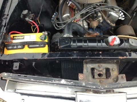

We let it idle for like 5-7 minutes before we drove it. Engine was strong and tranny shifted well and going from P to N to Drive was nice and tight. When I hit the gas it went! All lights inside and out work. It has a new EB intake and carb. When we returned I noticed the temp a little on the high side. I then popped the hood and noticed a little white smoke/vapor coming from the oil filler cap on the valve cover. I didn't see any type of smoke from the flow master pipes.
Could this be caused from it running a little warm... Or is this a rebuild sign from bad rings etc! It has a flex fan and no fan shroud currently. If I decide to purchase it I will change fan and add shroud.

Sounds like it is worth pulling the valve cover and seeing how it looks as far as moisture or sludge. Is there any oil floating on top of the water in the radiator?
Don't go by the dipstick alone, it is immersed in oil, so there may not be moisture indicated.
You know a compression test on this engine would be a good idea too.
