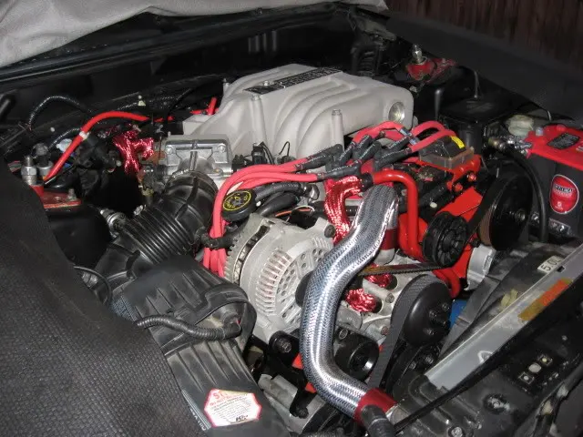

Now, all my hose clamps were nice and tight. But I put all these hose sleeves over my hoses, to make everything all pretty. Here's a pic of the engine before this happened:
The heater hoses are the red things off to the left of the throttle body. To keep the hose sleeves from fraying, you're supposed to wrap the ends in electrical tape. In some cases, this meant I had the hose clamp directly on the electrical tape. Add in several heat cycles, and the electrical tape softened enough so the hose slipped out from under the clamp. Oops.
Now I get to go through all the hose clamps and remove all the electrical tape under the hose clamps. Good thing is, I don't have to buy another expensive aluminum radiator.
