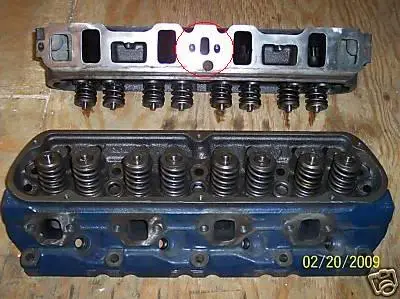

The fox setup get's it's EGR gasses internally. The heads have a port on them which allow the gasses to flow through a crossover tube in the lower intake and into the upper. From there it flows to the EGR spacer, out of it into the EGR valve and does a U turn back into the intake tract. If you use all fox parts with a Fox EGR valve and spacer, you'll pass the visual inspection. Now, you metioned not knowing if your heads have the proper provision for internal EGR, I'm not sure either, but if you have all the equipment on there then you should pass the visual.
Here's a picture, circled in red is where the Fox's get their EGR gasses from:
