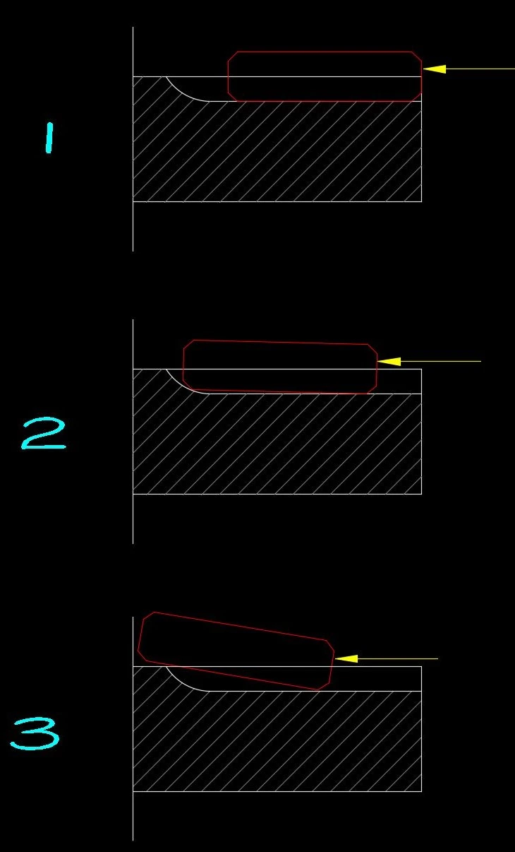

I accidentally found this method. I didn't realize the key was tapered on each end. I took a precision screwdriver and a belt grinder and put a super thin edge on it. That didn't work. I thought i could force it under the key and lift it up. Nope. But the key did move back a little. Hmmm. So i got a regular screwdriver and tapped the key into the compressor.... Yellow arrow. When the key made it to the radius in the keyway it just lifted up and fell out. Took about 20 seconds. No blood! Who knew.
