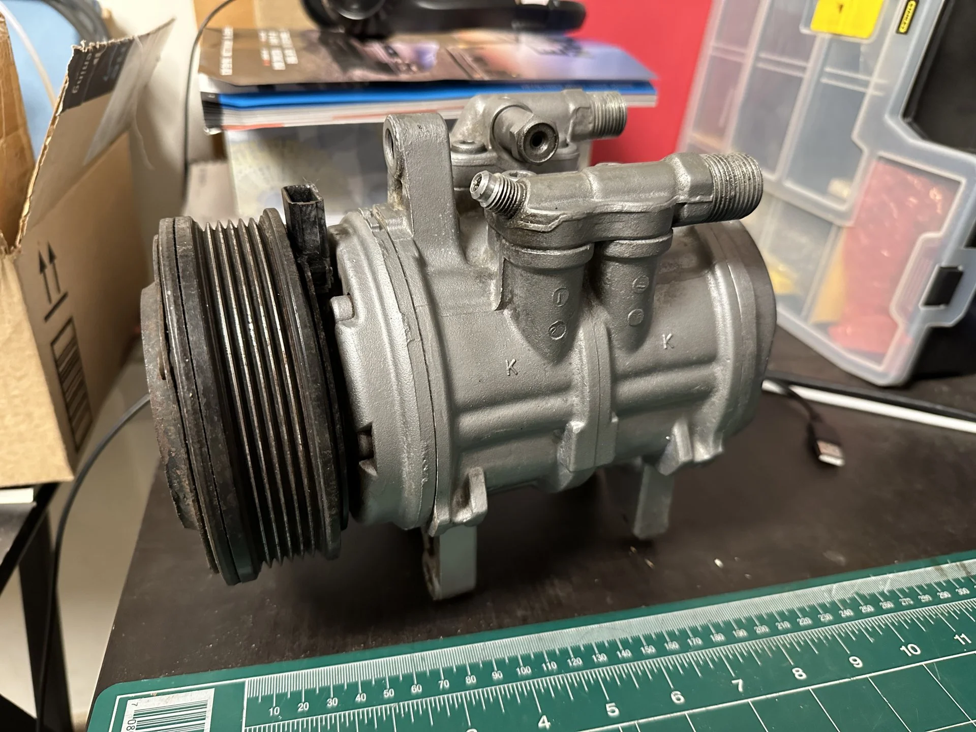

So I ended up getting my hands on a clean F0ZH-19D623-BA compressor. I ordered the parts to rebuild this. The main seals are easy to find, but the shaft seal seems to be harder to get these days.
I ordered a shaft seal kit based on some of the comments in this thread so I’ll update when the parts all come in.

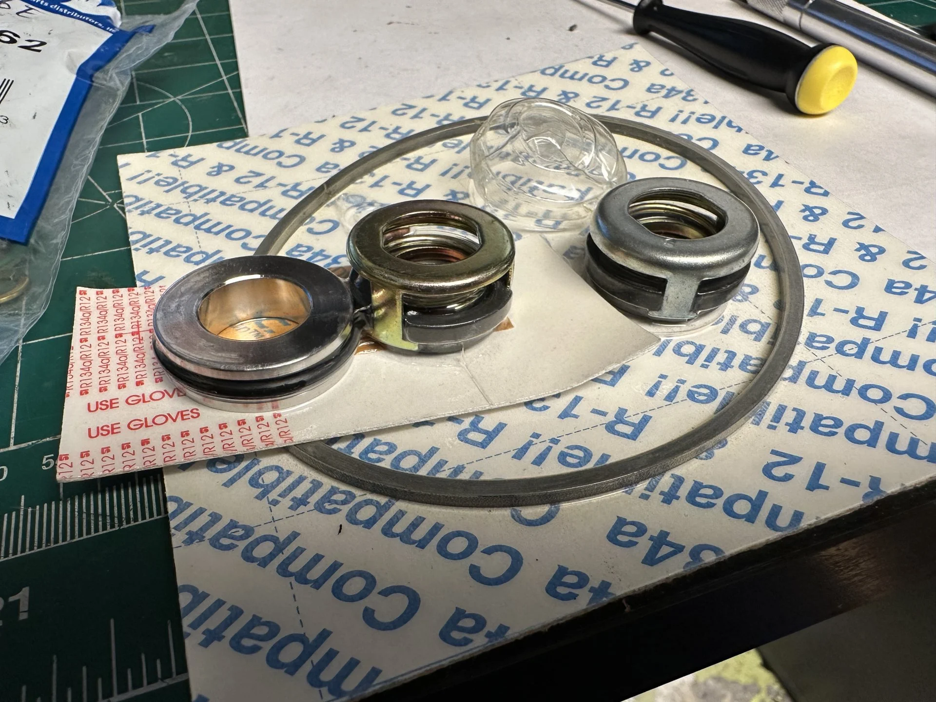

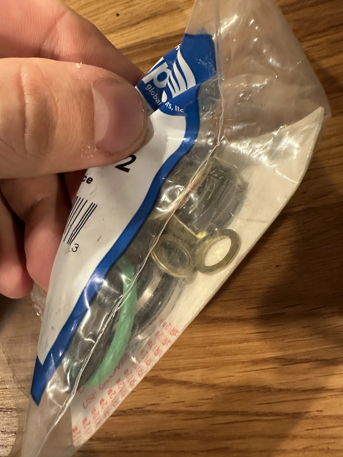

Got the new shaft seal from a different vendor. Need to confirm but it looks right.

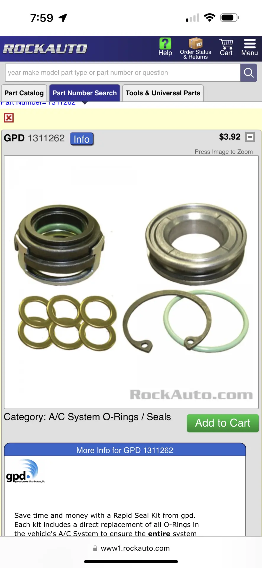

GPD 1311262
Got it off Rockauto at the cheapest price. Looks like the correct seals, plus new crush washers for the bolts as well as a new c-clip and a misc O-ring I’ll need to identify. Seems as if it’s the parts needed to pull the clutch and front cover off to only change the shaft seal. I’ll open this up shortly to confirm
Body o-rings should be here shortly.
GPD 1311262
What's the difference between that GPD kit and the Omega Environmental Technologies MT2039 shaft seal kit (which I think is the same as the Santech K20-3115 seal kit) that I currently have squirreled away for possible future use? Quite a difference in price too (<$4 vs >$21), which leads me to believe there is some difference between them.
Unknown. The photos looks exactly the same as the GPD kit. I have to imagine there aren’t many vendors making shaft seal kits for a 30+ year old compressor.

Bought new SS bolts as well. Now to find time to sit down and do it. I am going to reuse the clutch. It looks to be in excellent shape.

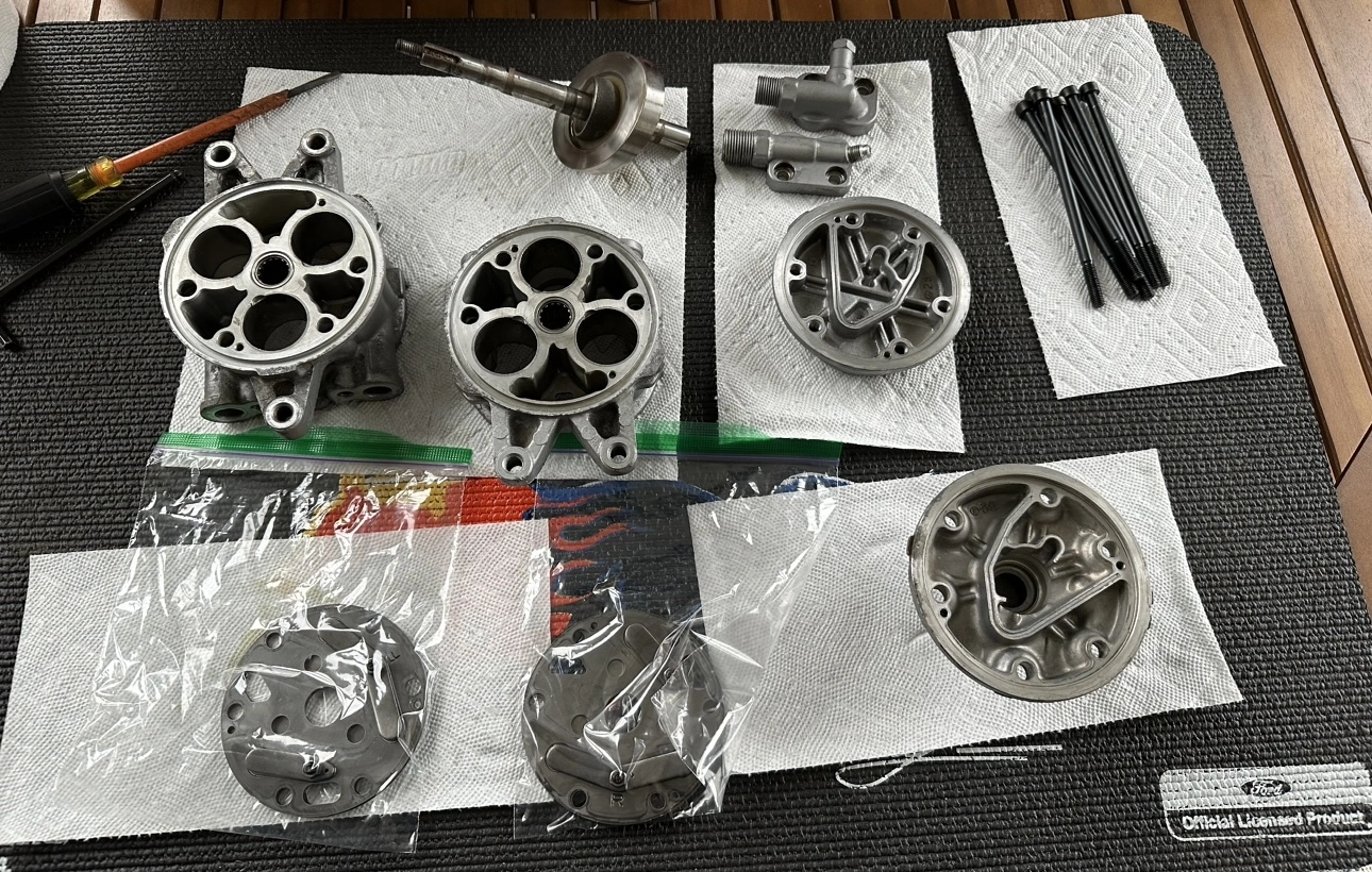

Pretty straightford now. Not much to these. This compressor was even cleaner than the one I previously rebuilt. My guess is that it recently came off the car.
I did make a YouTube vid showing me tearing this thing down.
Next up, fully clean this up, and paint the housing.
