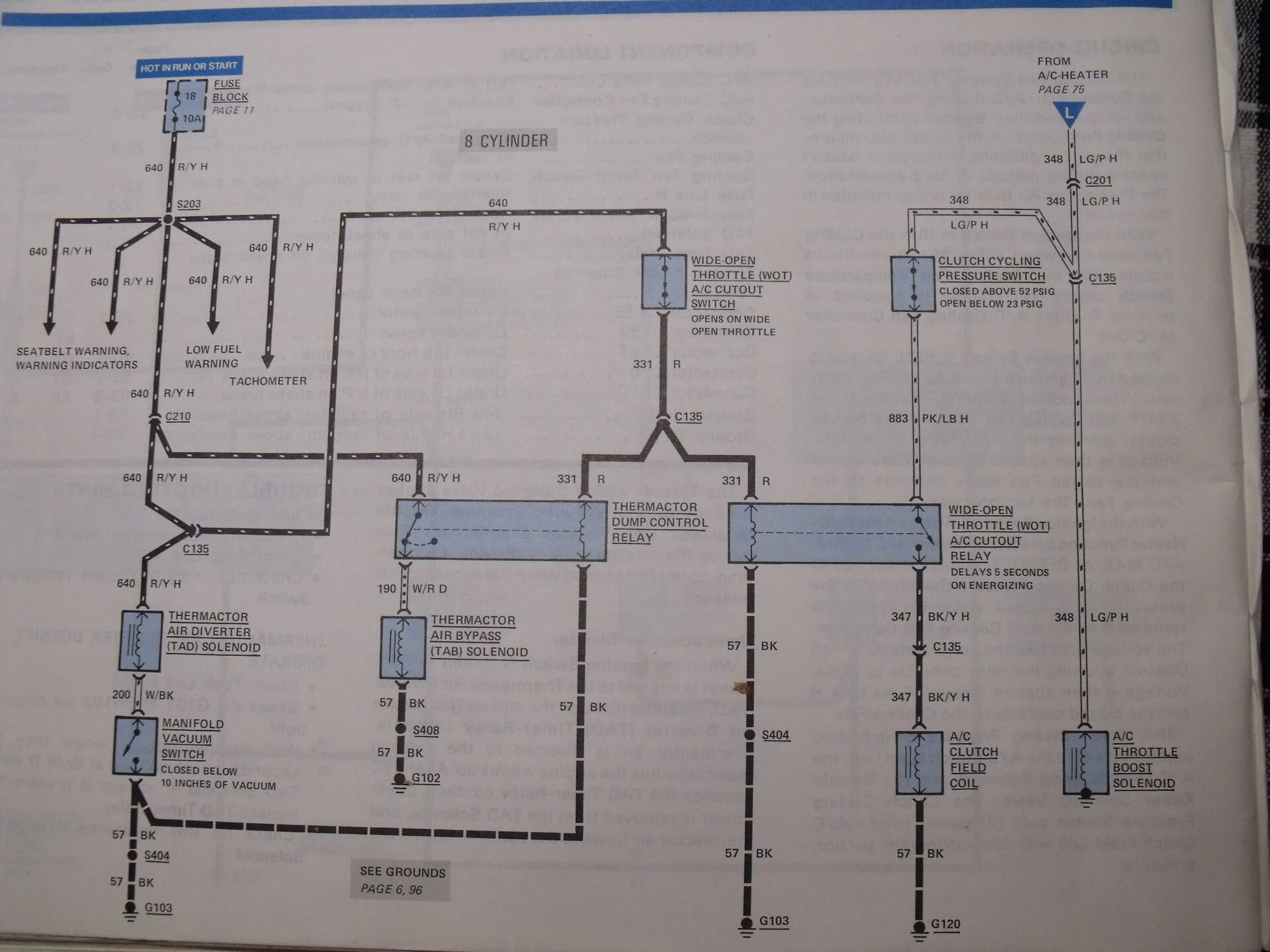

Is the pressure switch what cycles the Compressor clutch off and on??
My 83 ( no computer, carbed) has this wire running through a WOT relay that I want to eliminate.....
By passing this relay, I should be able to run this wire directly from my pressure switch to the compressor clutch with no side effects???
MIne is about the same, except for where the cut off switch gets power ( fuse #18) and runs through the thermactor dump control relay and the cut off relay..
I am going to start making a new engine harness ( the old one is shot) after I get the engine back in and while the dash is out. Hoping the engine will be going back in next week........
I do not think parts for the cut off switch ( which mount to the carb/throttle) will be obtainable...... Since the Tab/Tad system will not be going back on the car the thermactor dump relay will be removed and after looking at the WOT/cut off system, I would like to remove the WOT relay and wire the low pressure switch directly to the compressor clutch?/ I see no reason why this would not work, but wondering what others think?????

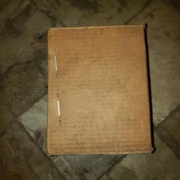

Well, I found one in my attic, and there is a Motorcraft number
YC138 compressor kit
Youi know they come new with no pulley, hub or field coil right?
I probably have those too (maybe) I have gotten rid of a bunch of stuff
The part numbers of that chit I will have a hard time with
Maybe shoot a few pics of your pulley
I need to know your Mustang is worthy of this new compressor I have been saving for 30 years
SVO sounds like it is (I almost bought a 1985 SVO)
My box is unopened Do not want to open it unnecessarily
