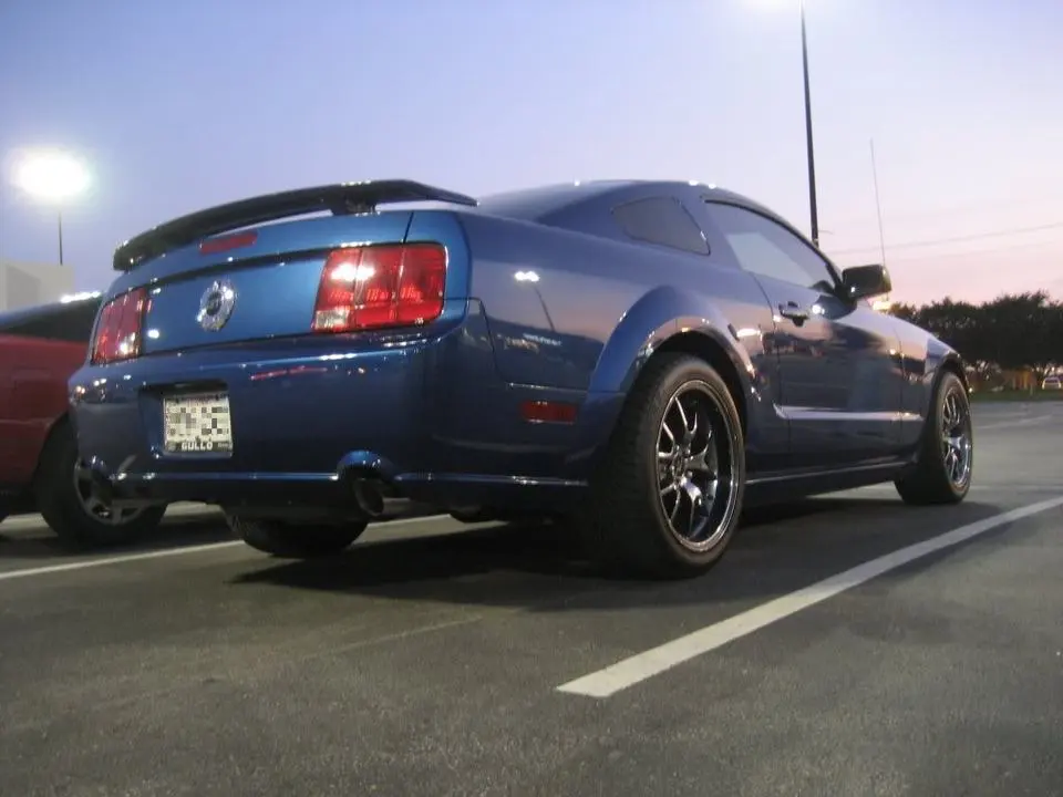

I'm almost positive (99.9% sure) that mine are 30mm and 40mm and they are from Wheel Replicas. They fit perfectly. The 24mm wouldn't be bad on the front, but you definitely want 40mm for the rear.

Mine are 18x9 with a 30mm offset and rears are 18x10 with 40mm as the offset.
Car looks like this thanks to some Black Chrome Magic
