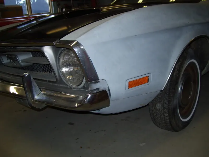

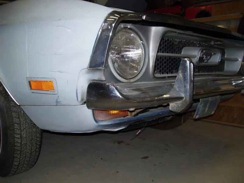

So I have my project car, and well I kinda feel like that song, 1 piece at a time by johnny cash, the car I know is/was a 73. but the PO told me that the guy he got it from had replaced the front end off a wrecked 72 onto it because there were some damaged parts that he couldn't get and he had the 72.
My biggest problem now is bumper alignment. it looks like to me that I have a early grill, bumper and valance but 73 fenders? thats why my bumper sits so low looking? the top of the bumper is flush with the flat shelf at the bottom of the grill assm. But I don't have another to compare to, I know that the 73's bumper reliefs were higher up on the 73 vs the 71-72 but the pictures I find don't seem to give me a good ID on how far above the marker lights they should be. professional opinions,
Or is it that something is screwy with my bumper and it just needs raised up?

Where should it be on a 73? Would you have a pic to reference so I might see to understand. Second question, I crawled under the car, nothing appears to be out of my place or bent, why would my bumper sit so low, from what Ive seen of the brackets they are he same 71-73?

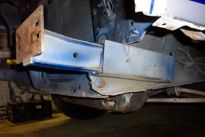

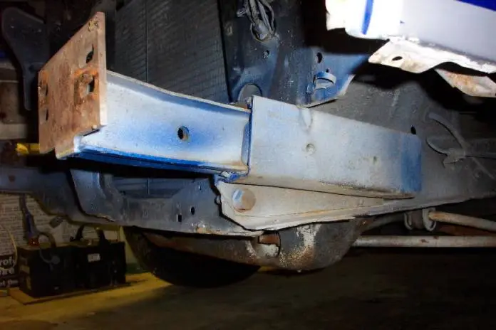

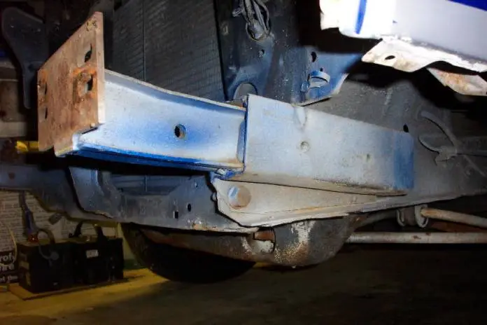

This is a 71-72 Bumper Bracket:
This is a 73 Bumper Bracket:

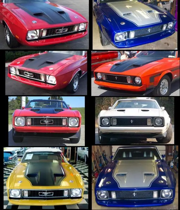

Compare these 73 Mustang pictures to yours:
I def. have the 71-2 brackets. It almost looks as though the top of the bumper relief in the fender sits lower on the 73 vs the 71-2?
The whole reason I ask is the chrome bumper is tweeked and needs replaced, If my fenders are 73's I don't want to buy another chrome bumper and have it not work with my fenders when i can buy a used 73 bumper somewhere
You are correct: The bumper relief in the 73 fender is lower. The final proof that you have 71-72 fenders is the rubber pieces in that bumper relief area can not be installed on 73 fenders.

So it looks like the pro has indeed swapped the entire front clip off a 71-2 then. I wonder if something is bent, do the 73's use the same mounting holes for their brackets as the 71-2? Could he have them in the wrong location? BTW thanks for the help. I've learned a lot
I suspect the bumper bracket mounting holes are identical (I'd check, but the 71-72's are buried in snow). The only reason the brackets and bumper changed was to meet new impact regulations. Looking at the 71-72 bracket image above, there appears to be quite a bit of adjustability in those obround holes. However, it wouldn't suprise me if your brackets are damaged = they're not capable of handling much, if any, impact (hence the regulation/design change).
