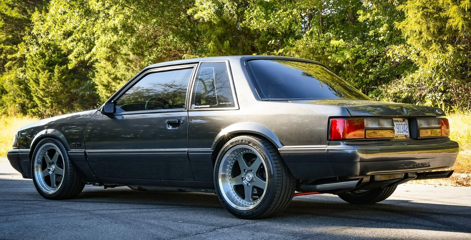

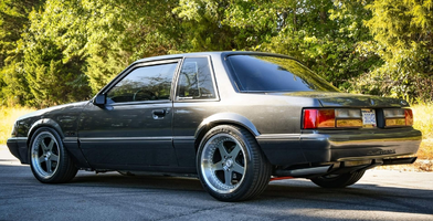

Rack limiters already installed by the previous owner, it rubs due to ride height and tire size. I wonder if I'll have to bring the front up a tad if I use spacers. Fenders have also been rolled.

That picture looks like the rear is an incorrect back spacing. The front seems to sit perfect. The back definitely sticks out.
I bought it this way and I've heard from several armchair mechanics the reasons why the rear wheels stick out a little... the rear is out of an old Lincoln Mark III, the SN95 brakes on it cause them to stick out, the axles are wrong and should be changed to standard Fox axles, and the wheel backspacing is wrong (was told it is 20). So I'm not sure why they do,. I could change everything on the list to see.

I'll agree too, the front looks right, the rear doesn't.
A lincoln Mark 3? With SN95 brakes? Do you mean a Mark 7? There are offset brackets to allow you to run fox lenght axles to fix that. I would just confirm 100% what you have first before recommending parts.
Do you have a shot down the side to see how far the wheels stick out? I actually think the front is fine. I agree that it's the rear that should come in slightly. I imagine you are hitting the fender lips?

The car at a minimum does have the wrong length axles . You have any pics with wheel off to see the brakes and stuff . Worst case it’s an axle and a caliper bracket backing plate swap . Wheels are fine plenty have ran them
Beautiful car btw
