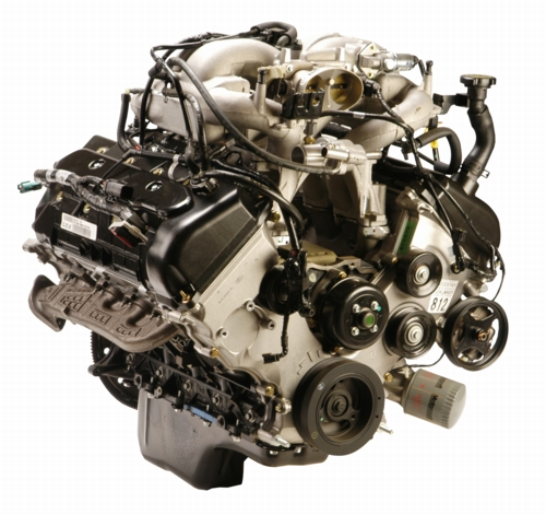

M-6007-NA54 MSRP $4395.00
Let the 5.4 DOHC conversions commence.
Won't you still have to pull the heads, gut the block and replace all the internals, have the heads worked, install cams, etc etc...? Then replace the whole upper intake if you go w/boost... Seems like you're buying alot of extra stuff you don't need. Unless u just wanna swap motor for motor straight up, but I don't think you'd get your money's worth out of that :shrug:

All 5.4's have steel cranks now. So maybe Rods/pistons. But that's not the point. The 5.4 DOHC is not an easy engine to find yet, so having one available as a crate engine is a good thing.

Well, the Iron block is a plus. Steel crank similar to Cobra crank maybe? So you replace the rods n pistons and get the heads and cams done then add a blower... I guess thats not a bad deal...you have to swap computers too or can you flash a GT comp to work with that setup? Hmmm...now you got me thinking...5.4 Nav crate or stay 2V's with a VT long-block and cams??

Close, 329.63 inches (to be exact- 3.55 B x4.165 S) call it a 330. Doubt the heads need to be "done", but cams couldn't hurt.

The 5.4 DOHC was configured for torque. Look at it's peak torque point. 2750 rpm?!?! Where does the DOHC (non-blown) have peak torque? A lot higher in the power band. Swap that mountain of an intake for a short runner and see what happens. A lot more hp and still more torque for sure.
As for the reason for the very conservative numbers, the 4.6 DOHC has to move a 3500-4000 lbs car. The 5.4 DOHC was setup to move a 5500+ lb SUV.
