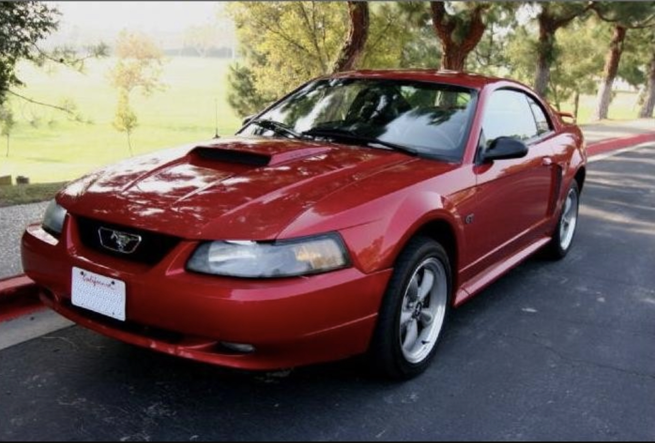

Hi everybody! Have 2001 GT. Bought it new in 2001. Been sitting for 7 or 8 years but starts with starting spray. Fuel mucky. Bought new tank and associated attachments. However, can't find a Pressure Regulator, the larger of the blue vent thingys on the top of the tank. Can ANYBODY help me find one? I also have to repair the AC Heater hose nipple coming off the manifold. Scott
