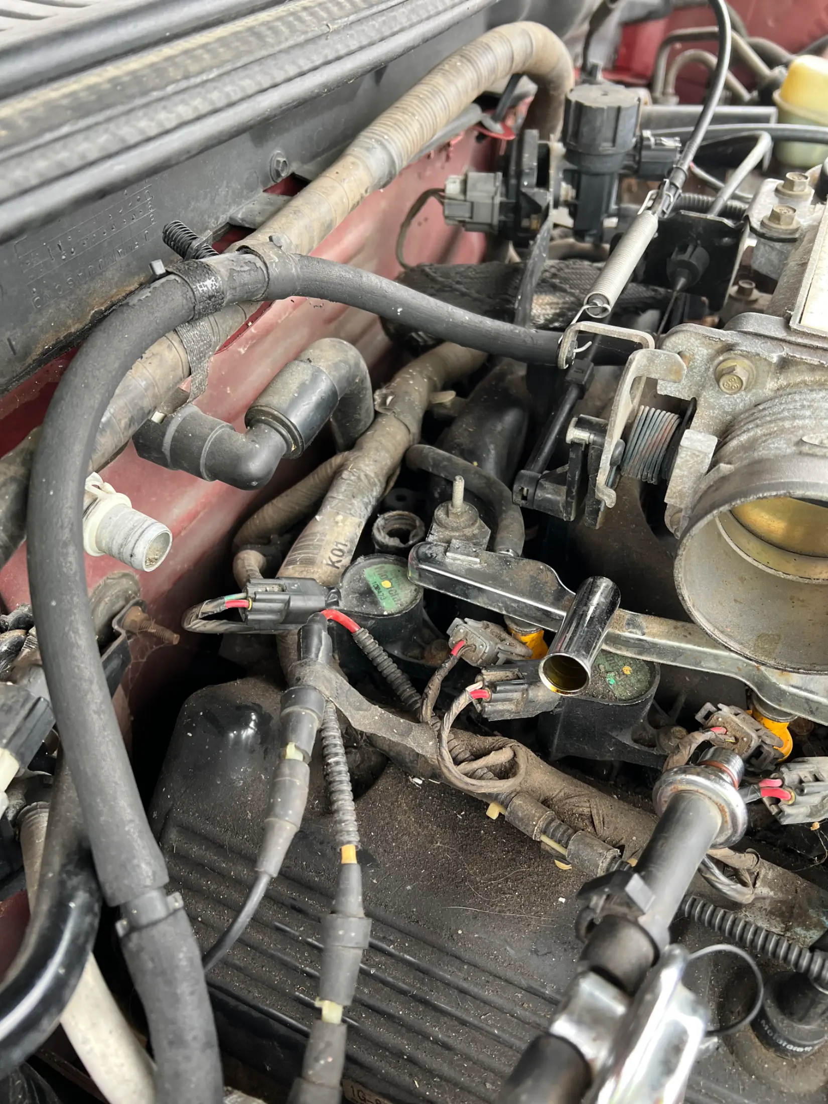

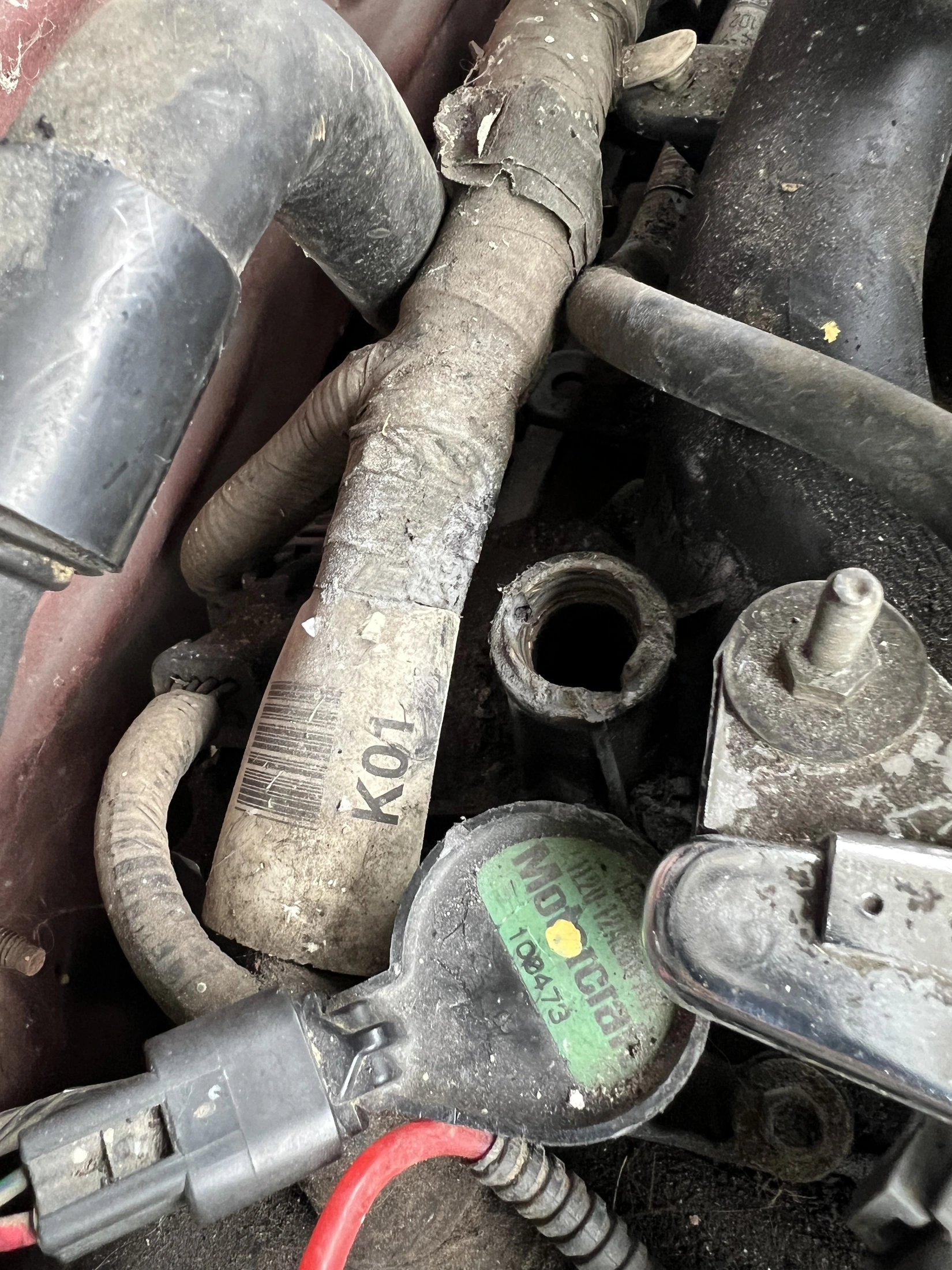

till need to repair the broken nipple from the manifold to the heater hose. Ugh!!!
pics

Later today…

If you have the intake with a plastic thermostat housing/crossover, I’d order a new intake.

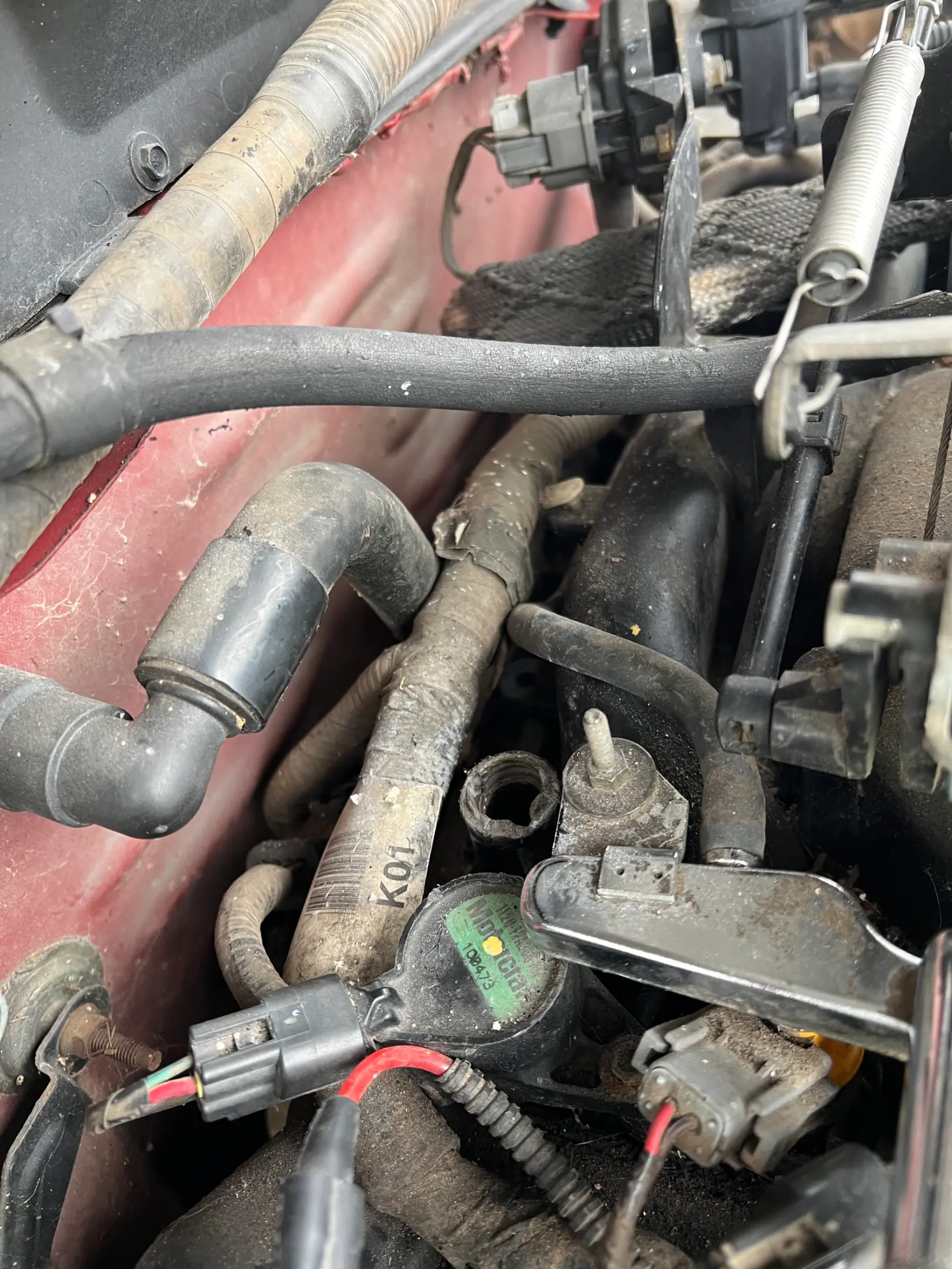

Noobz347 said:
pics
Sorry!!!! I was called away. Here are some pics.
