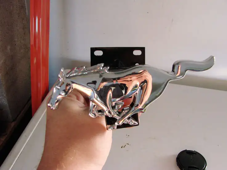

P.S. Also the pony that came in the kit is very crooked and the horse runs down hill when installed on the car...very upset about this as well, but ordered a new horse from american muscle and hope it will be better than the one I got elsewhere...

Thanks guys, Yeah I ordered a new horse from AM and got it in the mail yesterday and it looked totally different from the one I recieved from Blue Oval. The one from AM had a different looking bracket and the horse was good and straight. I emailed blue oval and since I bought the kit back in August and just now last weekend got an opportunity to install it there was nothing they would do since it was past the 30 day return period. Which I expected. I also asked him if it was actually factory ford pieces and he said yes he got everything from a local ford vendor. I really don't believe that now that I recieved the horse from AM and it came in a Ford box and all and it looked totally different from the one they sent me. I think I am going to order another piece from my local ford dealer and see if it works better. They are only 34 bucks directly from ford. Sorry I can't post pics right now cause just came to hospital with wife last night and we had our 3rd baby girl...so gonna be here for a few days now.

Ok, I finally got home from the hospital and here are some pics...hopefully I can get them to show up.
First here is the passengers side shot:
This shows the crooked horse installed:
This is the crooked horse uninstalled:
This is the new horse from AM uninstalled:
