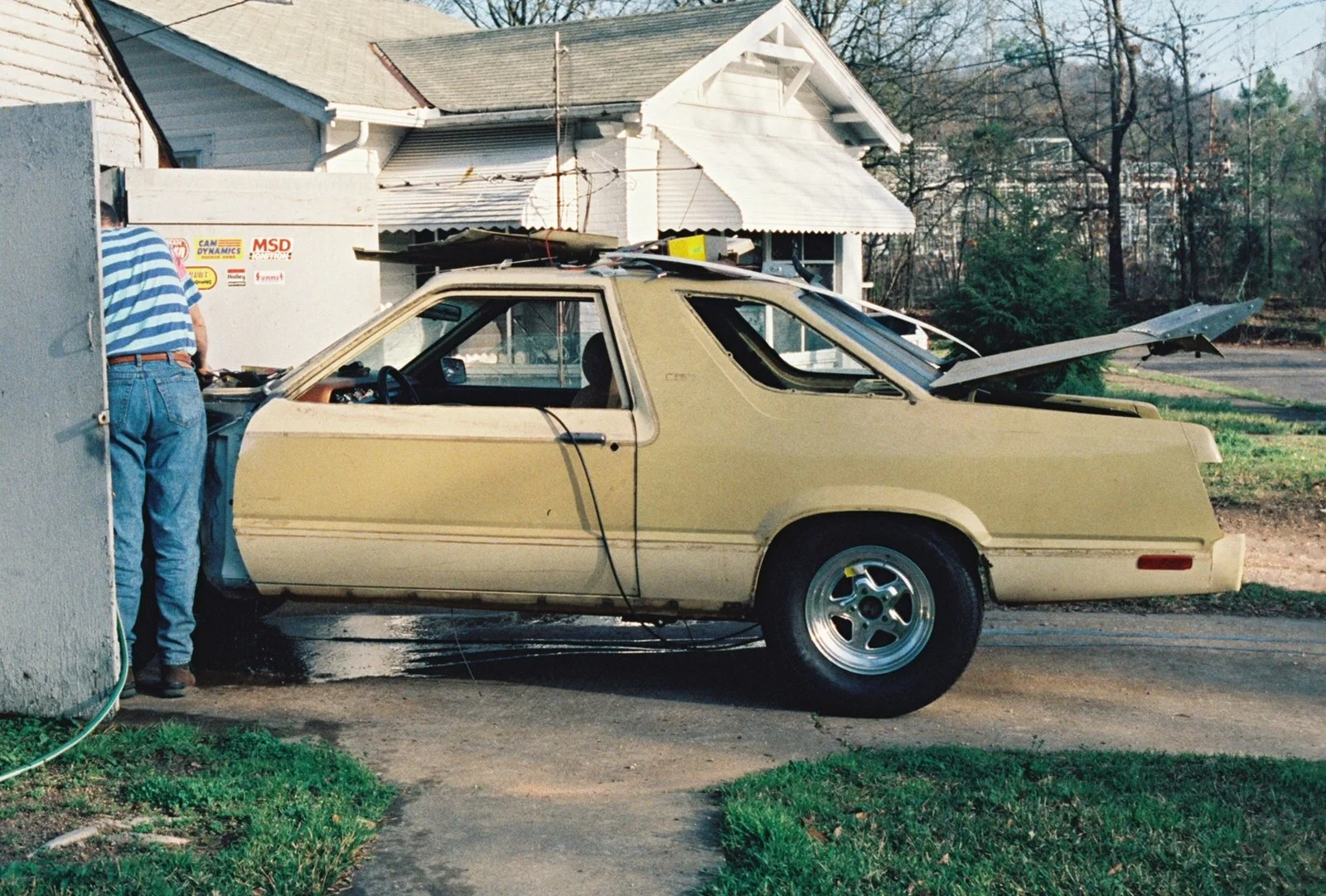

There's more than one guy here who's cut the factory wheel tubs out of the car to use as a guide. And if you can keep a car pointed forward you should be able to drive a sawzall through that sheet metal....but,..that was then.
I have mini tubbed 5 cars now since 1990.
The first time I did that I hadn't ever did something that complicated before.
I had a shop that did AC ductwork build the mini tubs off of cardboard templates that I gave them. They rolled the Pittsburg locks that allowed me to put the two pieces together ( side and top), and I riveted everything in after that.
I was 33 when I attempted that. I was broke, and couldn't afford to even pay attention back then..

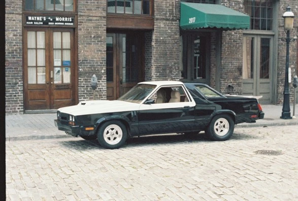

But I found a way...cause this car...
Became ..
This car.
Doing it yourself is the only way things go the way you want them to go..
It may take a few times...it may not be perfect,...it may require more effort than you want to give to the project. But when its done,.....
