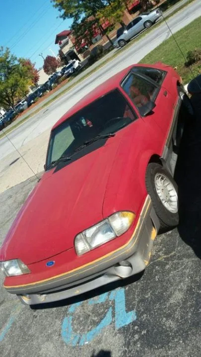

For now, here are a few pics. Here it is in the parking lot just before purchase:

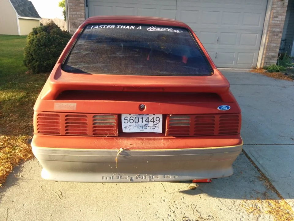

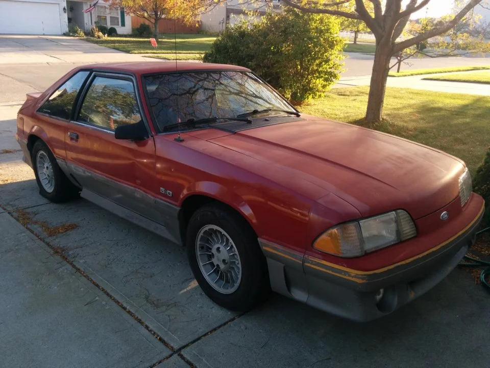

And here are a few pics in the driveway, after getting it home:

  • Gas dripping beneath the rear passenger quarter. You can just see the stain and rag in my third picture above. A new filler neck seal took care of that, though I can still smell gas in the same area, so there's something else.

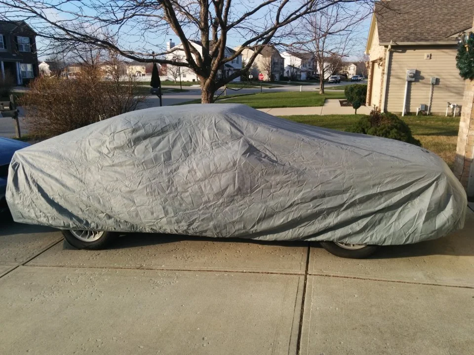

Winter mode for the project:
I intend to start it at least once a week, and drive it if the roads aren't all salty. I'm terrified of salt, because the poor thing has enough rust as it is.
