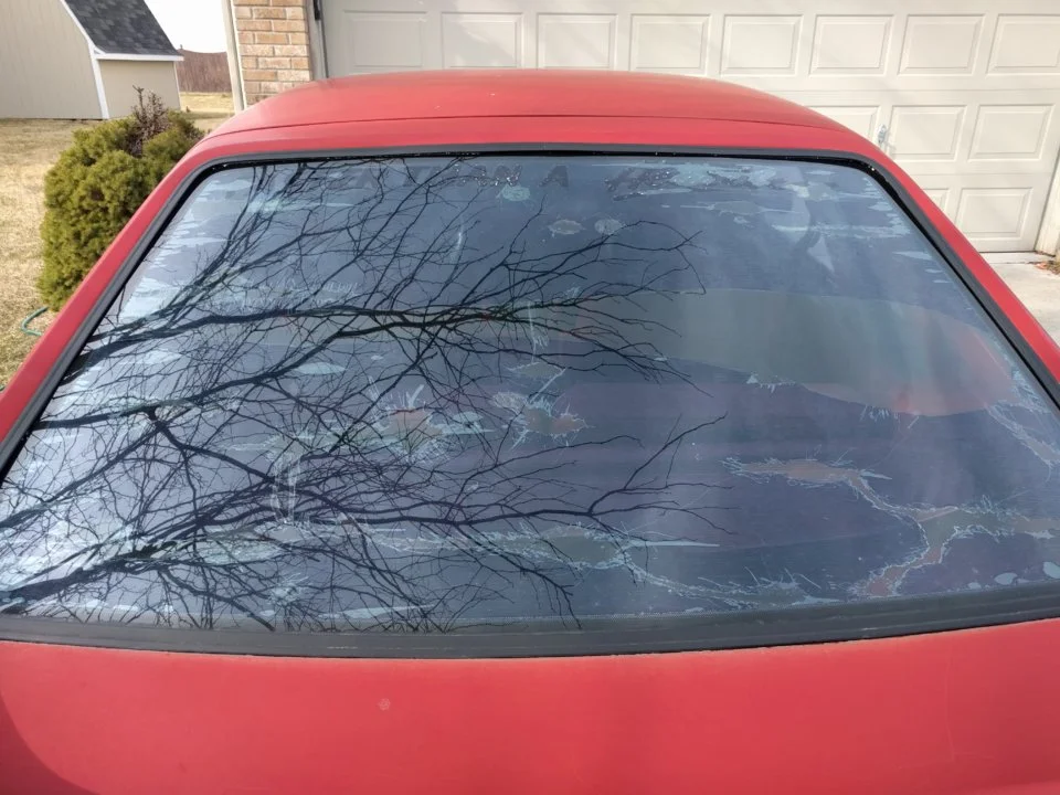

The wife has actually done more work on it than I have:
If you look closely, you can just make out where the "Faster Than A Heartbeat" sticker used to be. She also started pulling out the places where the tint was bubbling. Believe it or not, the visibility is better this way, because the bubbles weren't quite transparent. She got some tint remover spray to help, and it appears to have had a delayed effect on parts of the tint, so it looks like we might be able to pull some more of it off.

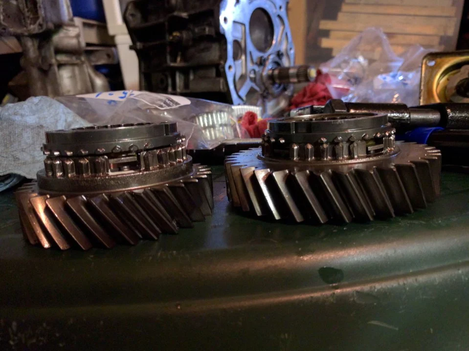

When last we heard from my old transmission, it was partially disassembled on a table in my garage. It's still partially disassembled, but now it's "as disassembled as it gets". The main shaft is totally apart, and I'm planning to leave the cluster shaft alone, because it appears to be in great shape and has no end play. "One challenge at a time" seems to be a prudent rule, even if it might be good to swap out the bearings while it's apart.
One question appears to have been resolved. I was wondering if I even needed all the transmission reworking, given how good things looked in this tranny. It appears that I did. Here are first and second gear, sitting next to each other with their synchro assemblies:
It might be hard to see, but there's a gap between the synchro teeth and the gear teeth on second (on the left), and no gap on first (on the right). If my sources are correct, that indicates a worn-out first gear synchro, which can cause the tranny to pop out of gear. Spinning them in place confirms it even more, as second "grabs" in a way that first doesn't. I suppose it's weirdly comforting that I was doomed to tread this path from the moment I bought the car.

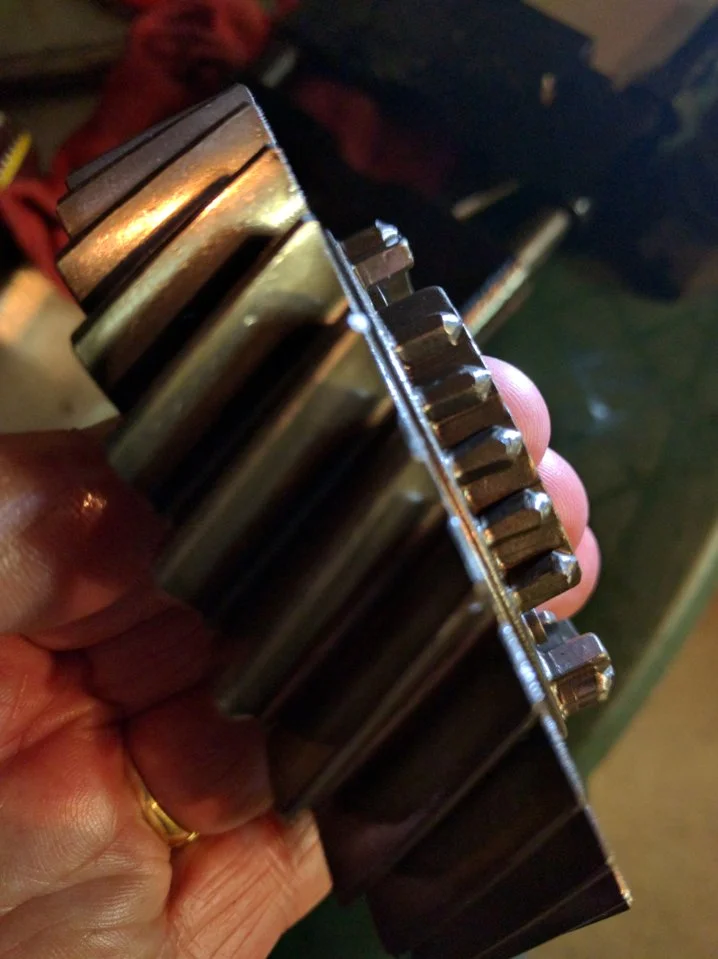

In better news, first gear looks to be in decent shape:
I know that's just part of the gear, but that's what things look like all around. The 1-2 slider looks equally good, as do the rest of the gears (which weren't giving me any trouble before). So, I should just be out the cost of a rebuild kit to get this going. I'm wondering if it's possible to omit the cluster shaft bearings from the kit, and whether doing so saves any money.

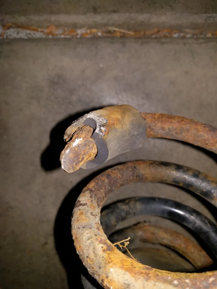

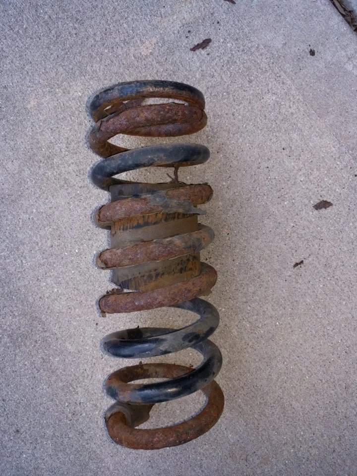

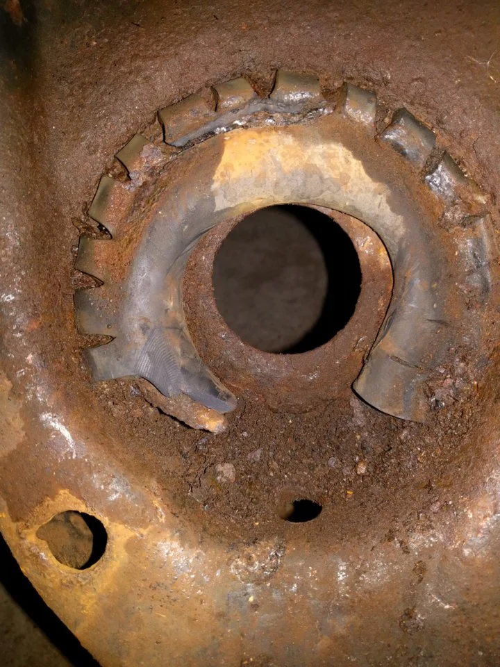

And I think I've found out why the poor car hit bumps so hard:
Yes, that's the rest of the spring peeking out from behind the so-called isolator. Worse, it appears the remainder of the spring is stuck hard on the control arm. I can stick a pry bar in there and lean on it.
Anyone have any tips for getting that loose?
ole smokey liquid wrench will get that sucker out of there.. Try a propane torch and some PB blaster.
