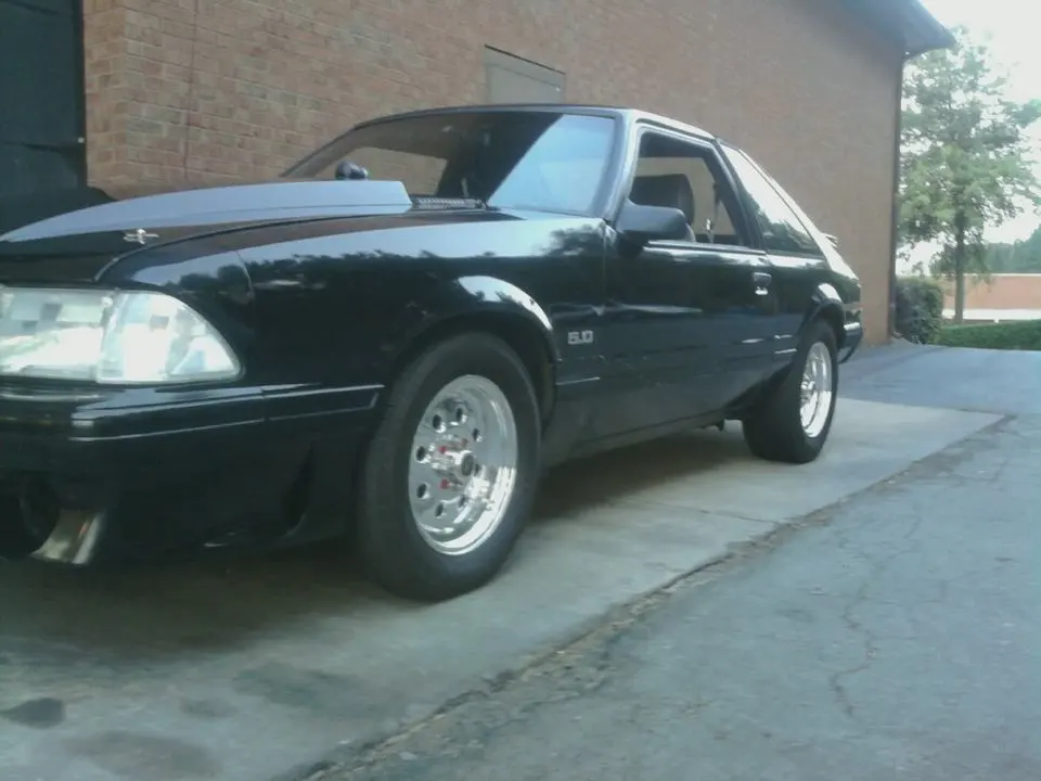

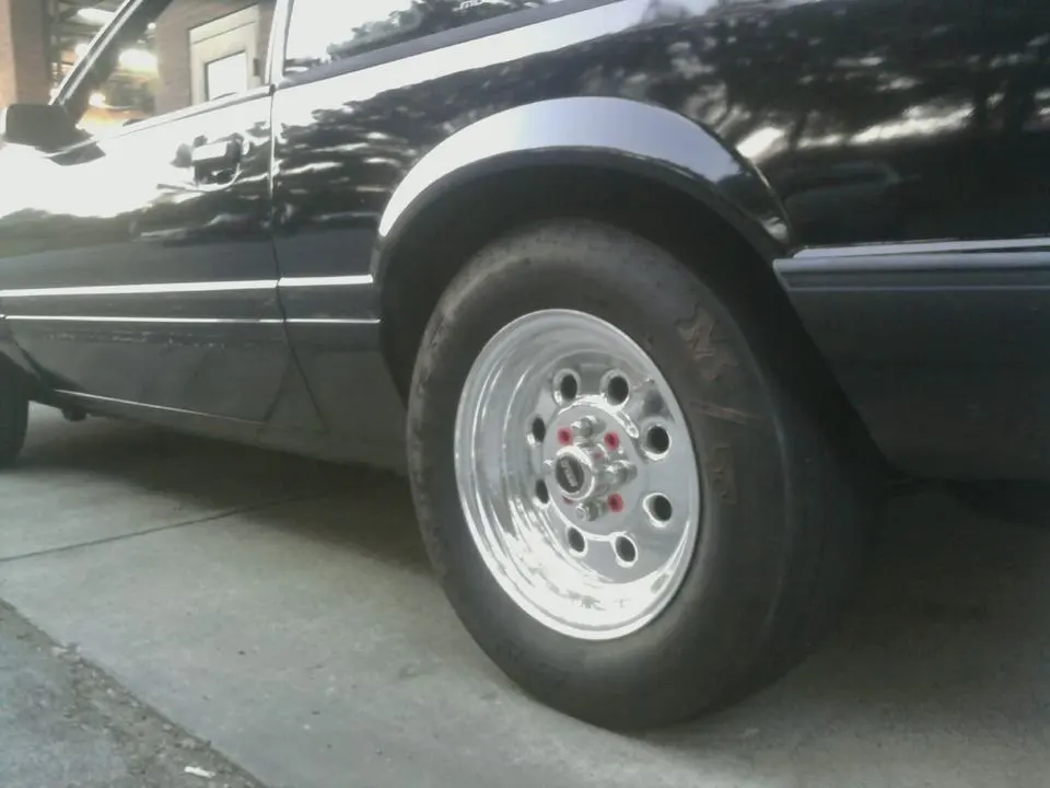

Put on the ET Streets!
Took it for a little drive. HUGE traction difference even at 22psi and cold. For the first time in this car, the tires have allowed the suspension to work. Stalled it up the little bit and let it loose, front end came way up and it was off and running. At the prepped track and a decent burnout, I know it will have more taction than the car will be able to break. These tires are bigger, but lighter. Another issue I found was the front brake lines were pinched. Free now. So the brakes work much better. Had to flip the quads too. Some say I don't need them, but just in case, they help.
I was afraid of this:
BEFORE:
225/60R15's :notnice:
AFTER:
26x10.50R15 :nice:
The tires fill the rim and wheel well now I don't know how I can bring myself to putting those crappy street tires back on. Not to mention the traction. I guess it's time to get some drag radials.
