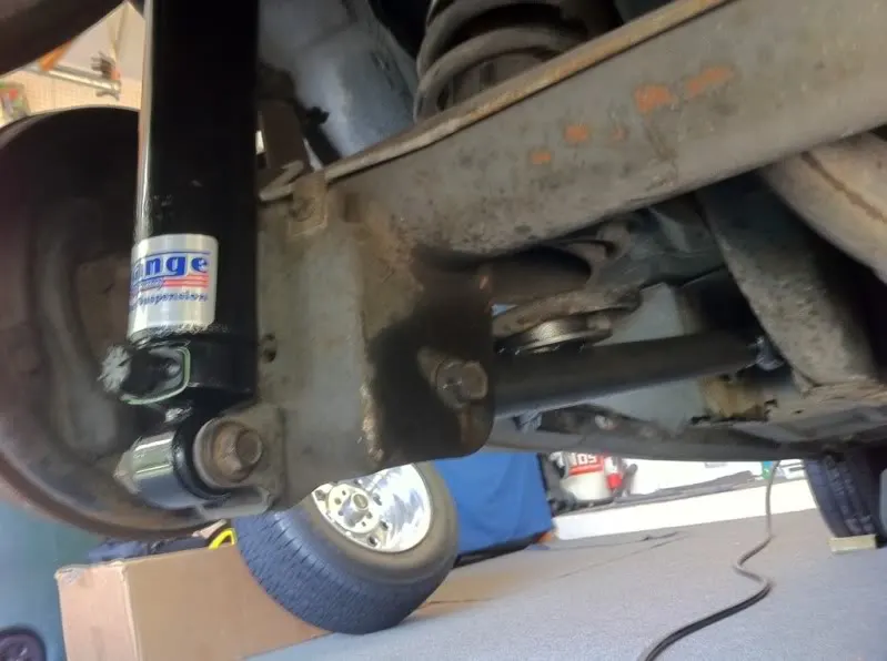

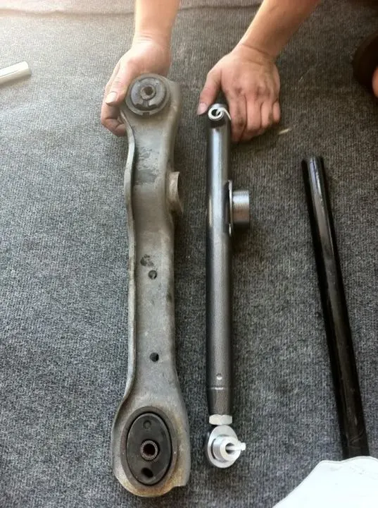

Also, here is TeamZ's lower control arms (see pic below). You will notice this drag racing application does not have the rear sway bar bungs. It's not needed in a drag race application. They offer Anti-Roll bar for side to side movement in place of the rear sway bar. There is no body roll unless your taking on / off ramps on the way to the track.
No rear sway bar.
Incorrect. The control arms without sway bar mounts are intended to be used with an anti roll bar that is mounted to the rear axle like this (my car):
If you're not using a racing style anti roll bar like this:
Then you should use the control arms with sway bar mounts like this:
Otherwise the car will body roll on the launch like the pic I posted, usually resulting in less traction on the right rear tire.
Incorrect. The anti roll bar does not control side to side movement. It is used to work against (anti) the body roll. High-end drag cars use wishbones like this to control the side to side motion:
