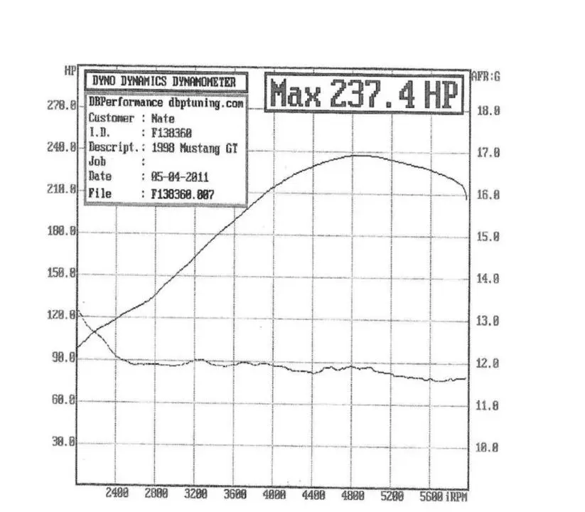

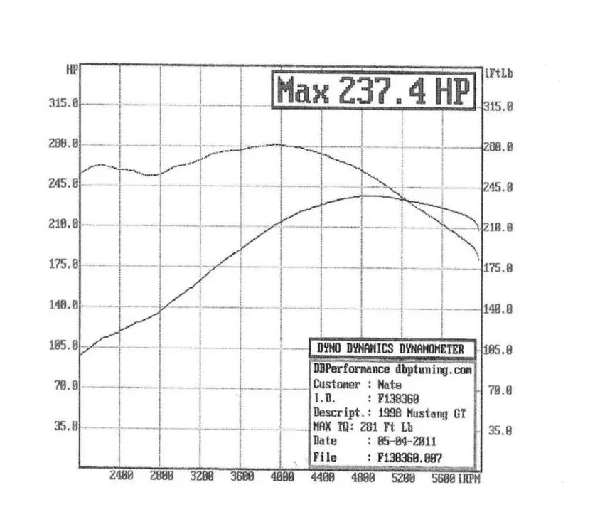

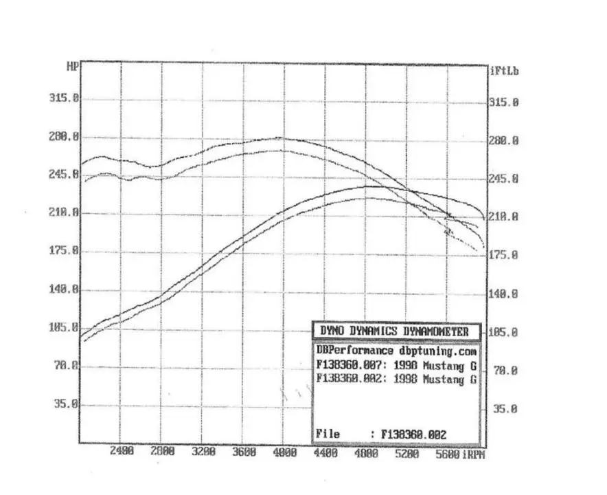

I guess I was just suprised that there are some of you on here w/ 99+ Mustangs running stock cams making around 270 RWHP. I figured with the PI intake, cams and my bolt on's I'd be close to that. He also said the gears hurt overall RWHP... oh well... it was fun seeing my car run on the dyno. I took some video and I'll try to figure out how to get it on the computer and post it up later. Here's my dyno sheets... I was really suprised that my car didn't pick up more in the tune alone. I mean I gained 12 RWHP after tuning. :(
I'm really happy with the fat a** torque curve though. She feels like a beast in the midrange.
Here's the comparison baseline vs tune
Here's the final HP/TQ curve
Here's the HP and AFR curve
He had the AFR at 12.5:1 and it actually picked up some power when he richened it up across the board.

Those are great numbers for your mods. Dyno dynamics are notorious for reading almost 10% lower than dynojets and 5% lower than mustang dynos on average- that puts you at roughly 260rwhp dynojet / 250rwhp mustang dyno so that you can compare with most of the numbers posted on here. Those are average guesses, each shop sometimes adjusts values but overall I think your numbers are very comparable to most of the bolt-on / cammed stangs on here. But numbers are just that, numbers. How the car drives and sounds are 100x more important than a benchmark number. :nice:
As everyone has been saying - long tubes would really help those cams out. An off road midpipe would net you <5hp but nothing like the long tubes. Plus I think a catted X sounds much smoother/better than the o/r. :p

It means that it makes 80% of your peak horsepower over a certain range. That ratio is an indicator of how well the car performs overall.
Here's how you calculate it: you take 80% of your peak horsepower; then you take the uppermost rpm that it makes that power and divide it by the lowermost rpm that it makes that power.
For example, with your dyno sheet:
80% of 237 is 190. The uppermost rpm that it makes 190 horsepower is at redline (6000 rpm), and the lowermost rpm that it makes 190 horsepower is at about 3800 rpm. So your 80% powerband ratio is 6000/3800, or about 1.6. The higher the ratio the better, and anything over 1.5 is pretty good. Two cars with the same peak horsepower, but one has a powerband ratio of 1.3 and the other has one of 1.7, the car with the 1.7 powerband ratio is going to walk all over the other car. And typically speaking, the bigger powerband ratio car is much more fun to drive.
I have a very similar powerband ratio as your car, and I can very well relate to how much fun it is to drive. :nice:
