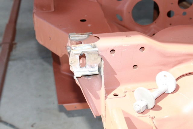

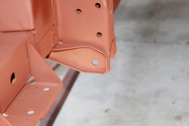

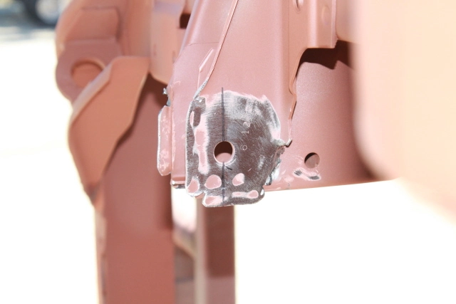

i lowerd the upper a arms ,1 inch down and 1/8 inch back. it requires a little hammering on the inside as well ,just to flatten some flanging around the holes. tomarrow i am going to work on the lower control arm mount. going to make it adjustable using the brackets off an old 68 front end . no more shims to adjust the front end. the radius rods will be changed with modified 67 rods so every thing will now be adjustable. i know ,a kit is available for the lower control mount but uncle Jim aint made of money!

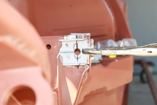

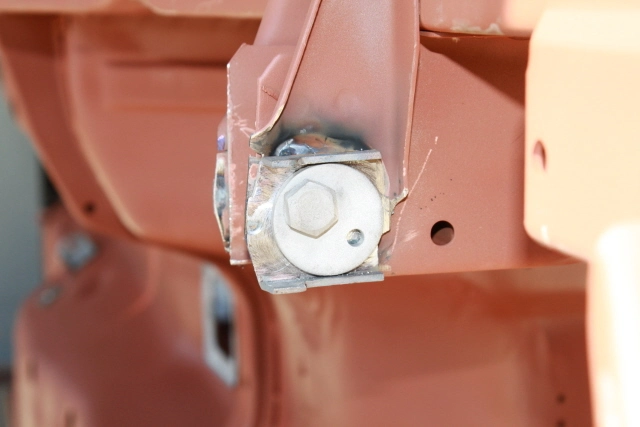

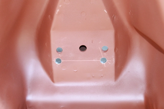

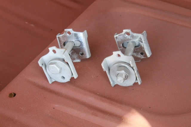

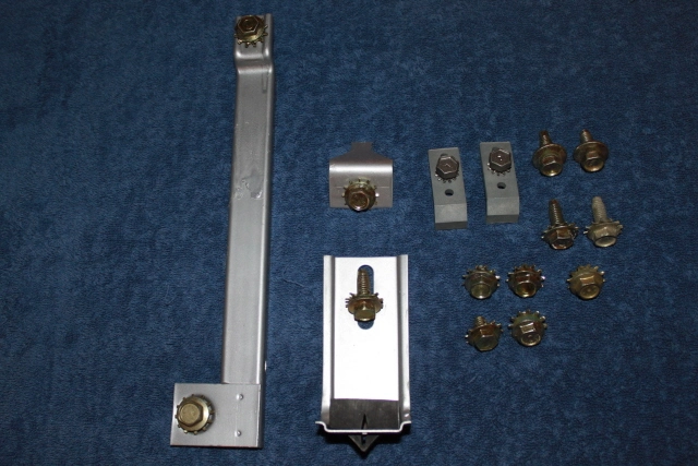

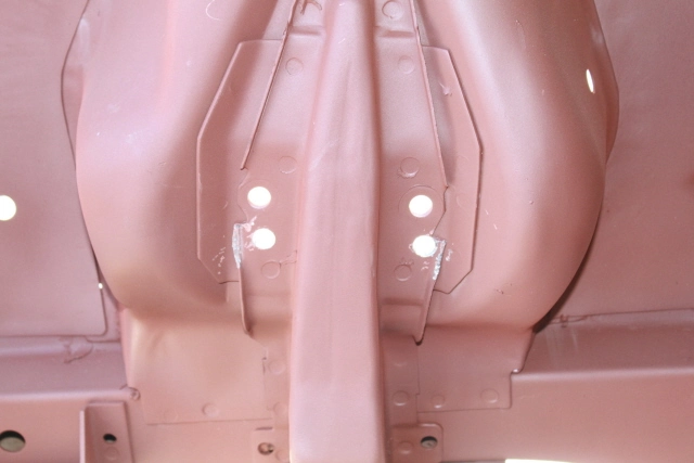

just finnished the lower controll arm mods. i used the old adjuster brackets form an old wrecked 68 front clip. there are only three spot welds holding them in place.simply drilled the spot welds and removed them. i had to modify the controll arm mount a little,nothing major. using a straight edge i conected the holes through the centers
marking it with a fine tip felt pen, the line will keep things parallel. i then took the brackets and marked the center of the adjuster hole horizontal and verticle like cross hairs and aligned the marks over the holes in the lower controll mount.now every thing will line up level and square ,this is a must to work properly.welded them in place through the spot weld holes and welded them up the sides for added strength.
i then used a 1/2 inch hole cutter to cut the ends of each slot and cleaned up the points that were left over with a die grinder .no more shims ,it adjust like a 67 up now.

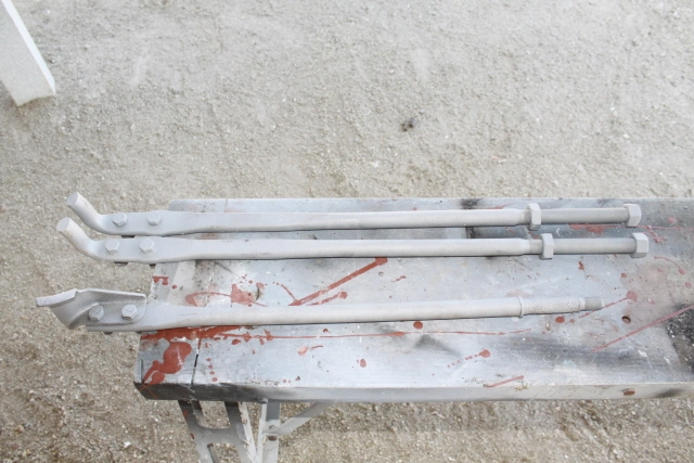

now i just have to find a set of lower radius rods for a 67 to modify and the suspension will be fully adjustable. a set of the positive lock adjusters and its good to go.

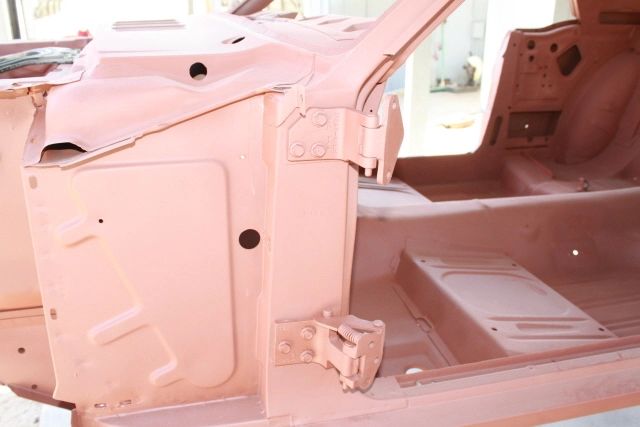

took the door hinges apart today and rebuilt them. sand blasted and primed as well.

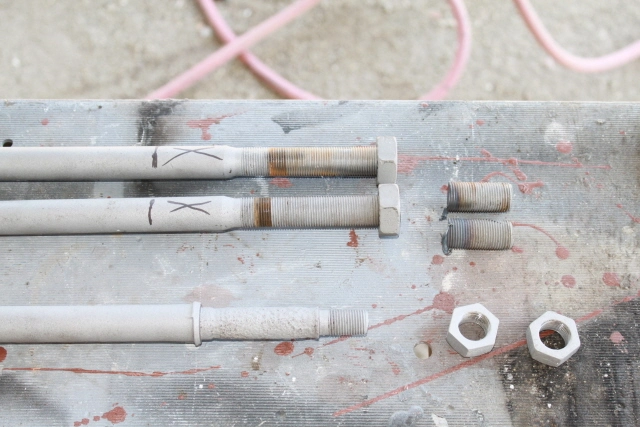

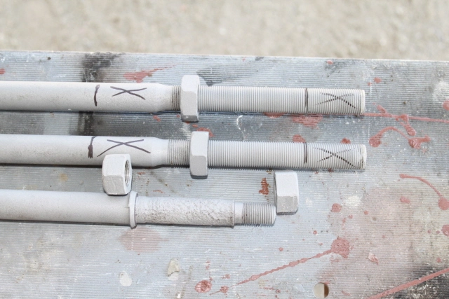

i found a set of the 67 radius rods. they have to be shortened to use them on 65 lower controll arms, about 1 1/4 inches. i also have to chuck them up in the lathe and turn them down in front of the threads and extend the threads ,room for adjustments and the front nut. that way i will have full adjustment for caster.

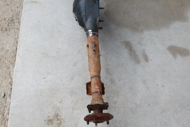

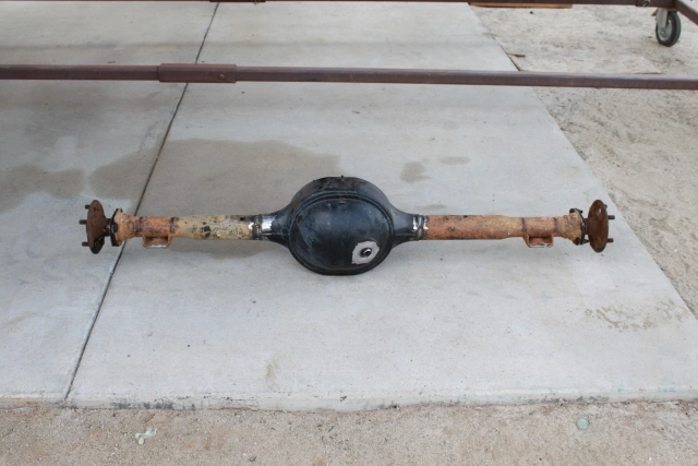

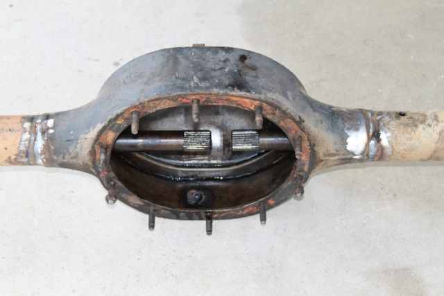

i built a 9 inch housing for nicks mustang. started with a 8 inch from a 65 GT coupe .
i used the axle tubes and the axles from the 8 inch and the center pumpkin from a early 9 inch. i have a jig for building rear end housings. 1 1/2 inch round bar and four solid blocks machined for a slip fit for the 1 1/2 inch bar .one in each axle tube a one on each side of a gutted center section ,they take the place of the bearings. it works out like a hi po rear end ,9 inch center with small axle tubes, the GT axles are the heavy duty ones . i just need to toss it in the solvent tank ,then glass bead the housing. i have a 3.25 geared center section ready to go .we will probably use drum brakes for now .i have a set up for 2 1/2 inch shoes .that should be good enough for now.it cost me about three hours work and no $s. thats the way i like it.

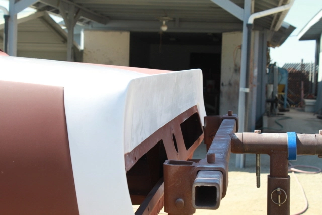

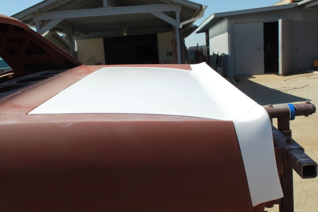

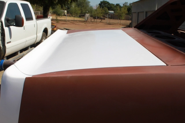

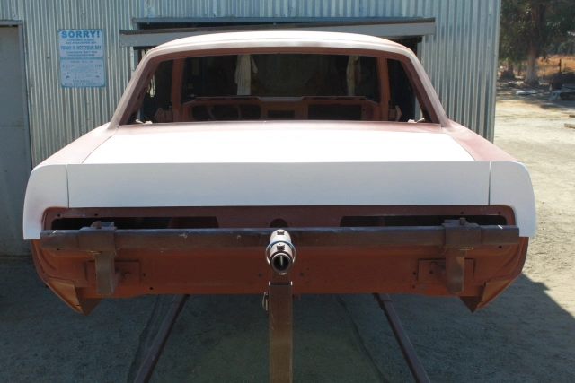

i picked up the fiberglass trunklid and end caps ,with the spoiler from stang- aholics. the trunk lid is just setting there .its not bolted down. just about a perfect fit right out of the box. the end caps needed the mounting holes in the body egged very slightly not alot. they fit just about as good as the origional caps, they also have a tail panel that uses the t bird lights like a 68 ,that i have orderd as well. it uses LED lights but i am going to use a set of 64 t bird light cans that i already have . it will be a whole lot cheaper this way. also thinking of using the 71-73 pop open gass cap. wanting to do somthing a little custome with the rear valance. just going to have to set down and draw something up. somthing like the 67 valance with the exhaust cut outs but a little different.
