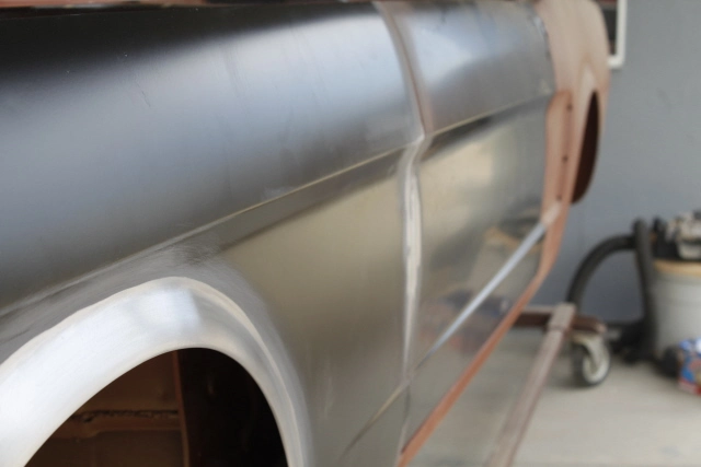

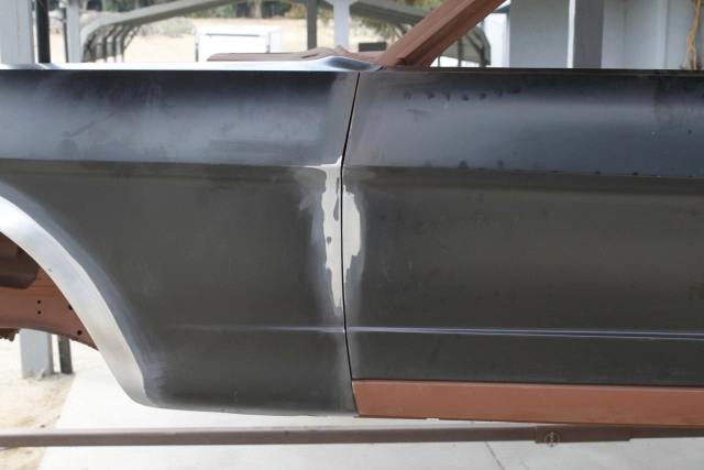

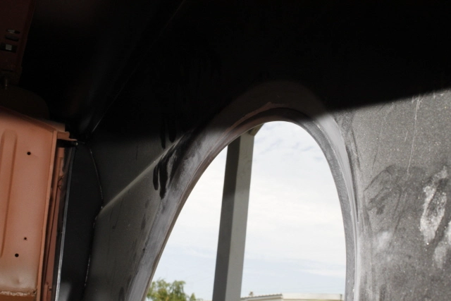

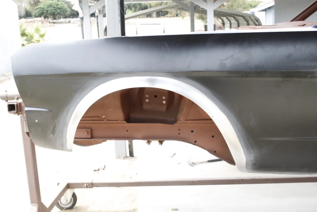

i got the gap looking real good now i still need to build up the upper edge a little with a mig then grind it to fit but i am happy with it now. the bottom at the rocker needs a little work. there is supposed to be about a 1 inch line across the bottom of the fender and it just rounds down,a pair of flanging pliers and i can bend in the line. i rolled the wheel lip with a 1/8 inch wire inside. it came out dent free and it is very strong .we have all the body panels now

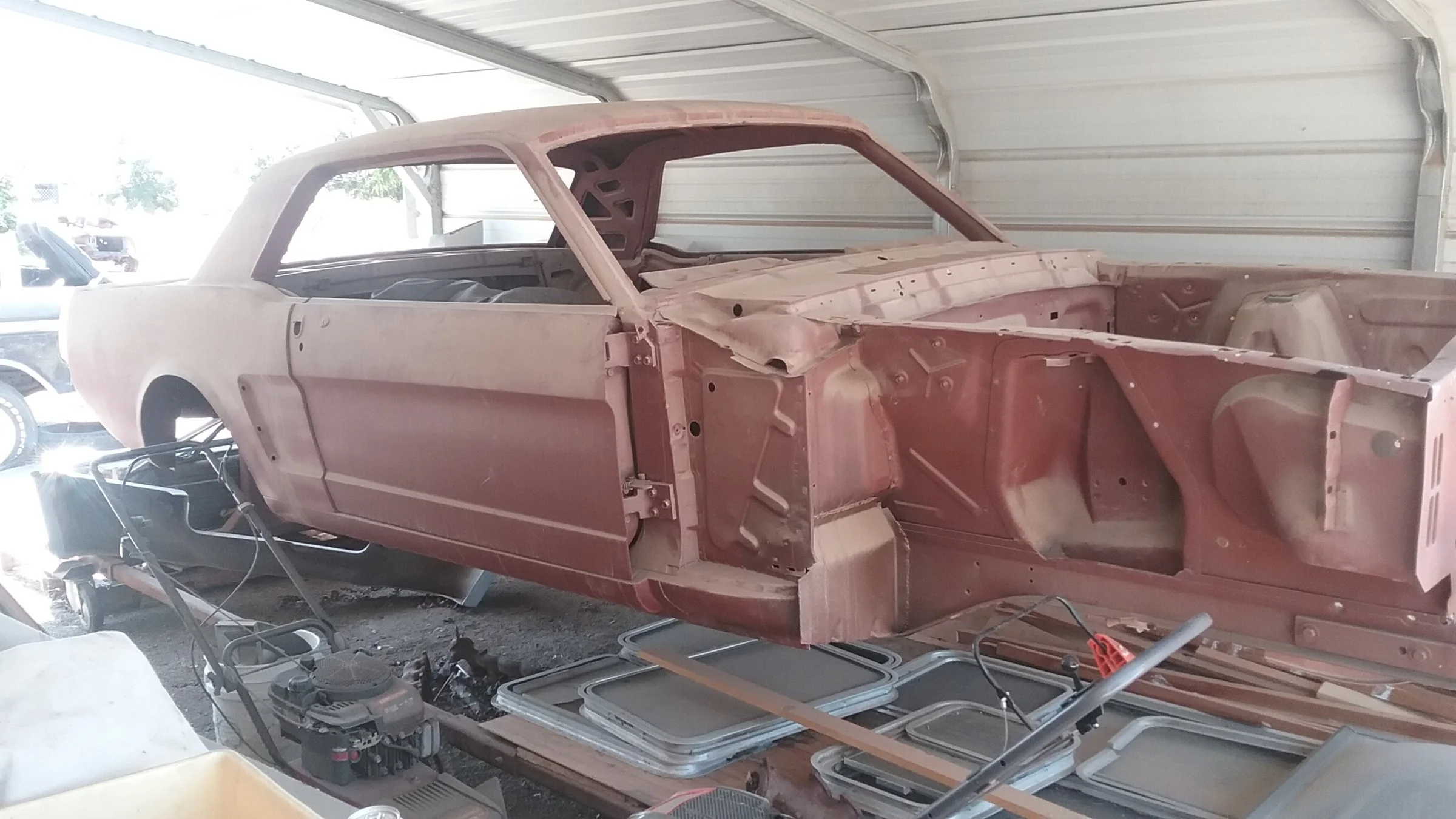

We will start working on it again pretty soon ,he is trying to get a job as a corrections officer in Fresno ,he gets that he will have a little money to play with.

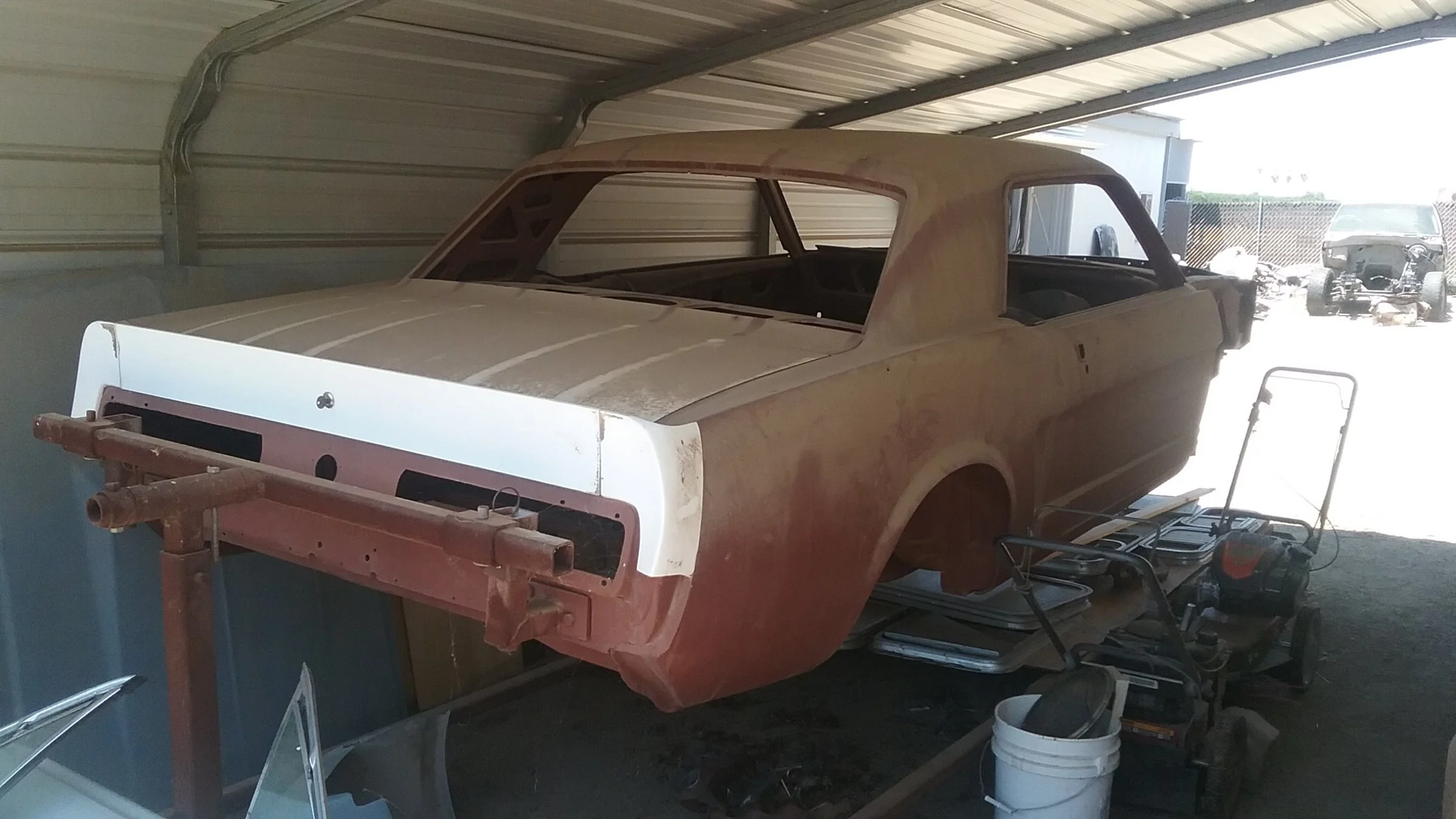

Those cool looking race stripes up the trunk lid are condensation drips in the dirt on the lid ,they go over the roof and down the cowl ...most paint shops couldnt get them that straight :rlaugh:
