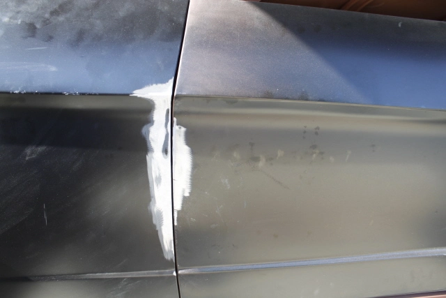

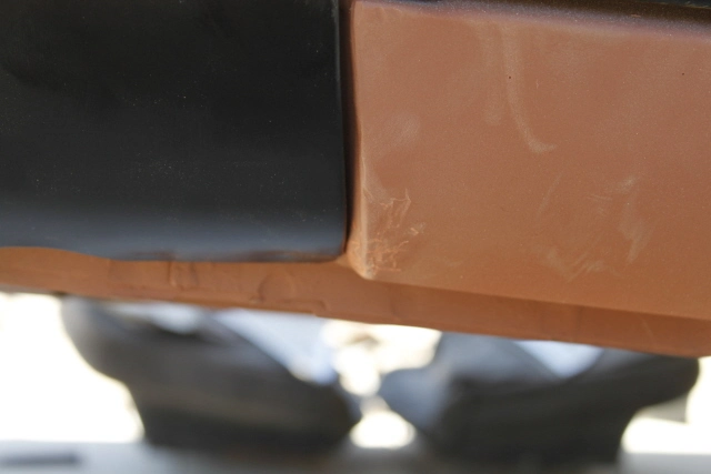

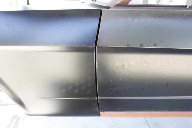

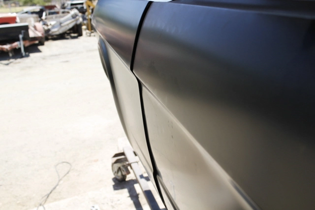

i got Nicks front fender today, NOT GOOD. it is strait but the fit up to the door is terrible. it has a 1/2 inch gap will not go back far enough . i will have to cut the inner brace loose and slide it forward ,bend the bottom of the fender down and take the bow out of the door end .the ford fender was just about as bad .going to take some work .:nonono:
Are they repro doors? I ended up welding the edge of the doors to match the fenders and quarters to bring the gap down to 3/16" on mine. I figured it was the reproduction doors that were the problem.
it's the fenders ,i tried them up to a origional door. the ford fender is strait instesd of having a curve where it meets the door. and the inner brace is located wrong it tne dynacorn fender.the dynacorn fender will fit better after i drill loose the brace and slide it back a little.and take out the bow.
i did some work on the dynacorn fender this morning.i had to grind about 3/16
out of the center of the fender and re weld the edge and i taped the edge of the door to get the gap right. the top at the cowl was to tall right beside the cowl so i had to grind it down. i bent the bottom down and took the bow out of the side .now we have a good fit and nice gap. the black coating is going to have to be removed ,it flakes off at the edges so i will take it down to bare metal. i tried the headlight extention and it fit fairly good ,a little knocking around at the front edge and it will be good. this fender fit a little better than the ford did. i am going to roll a wire into the wheel lip and it should be a good looking fender now. View attachment 81493 View attachment 81494 View attachment 81494 View attachment 81493
