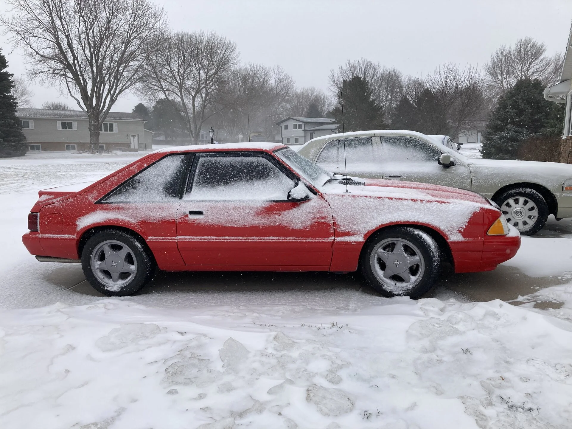

So much for the “never seen snow” thing.
The blizzard on the 23rd was short nasty, but the highs on Christmas Eve and Day were near 50. Oops. This is during a break in the snow and some 70 mph gusts. I think the posi works. It was quite a shopping trip. Even the 4x4 pickups and crossovers were spinning all 4 wheels trying to leave the stop signs and lights. At least almost no one else was in the stores I wanted to visit.
