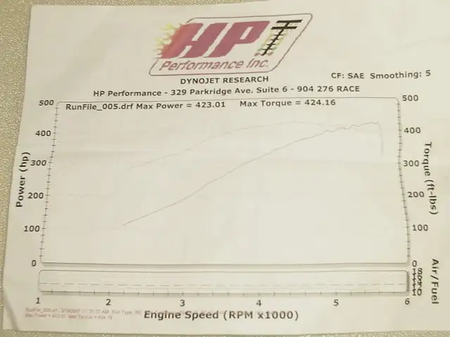

I don't know either. I was hoping to put down like 320 or so to the wheels, but it just busted out that 400+ reading and I was in disbelief myself. But Tony over at HP assured me that it was reading correctly. I'll take a look at my heads and make sure they're stock (or not!)..

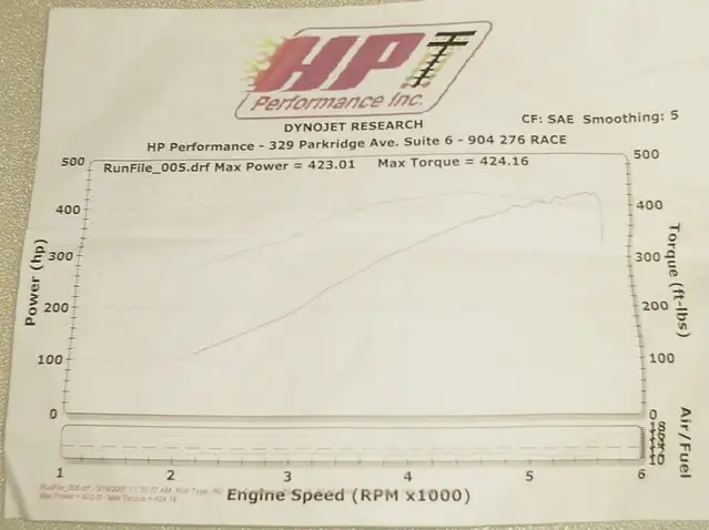

Here's a pic of the dyno sheet, had to use my camera, I don't own a scanner..:

for all of you in disbelief, my buddy made 360 to the wheels in a 90 lx fox with the same s/c, stock h/c/ and trickflow track heat intake w/ 8 psi boost. i would only assume another 5 psi could get him somewhere in the ballpark too :shrug: either way though, im impressed by how much the vortechs are puttin out. def more than my ex g/f:D

Doesn't that seem really low...considering you could probably pull off somewhere in the 280rwhp range with the h/c/i you have alone.
A local guy put down 415-425 with stock E7 heads, stock cam, gt40 intake and a vortec at 15lbs...he had every other damn bolt on and a speedbrain tuner but still pt down close to if not what you had...
Damn nice to see those combos put out that. :nice:

wow, nice .... but that seems more like 8# of boost to me.
i have always read that 14# of boost doubles the hp. so if you figure 280 for a gt40 combo, then 420 = 280+140 = 280 * 1.5, so the boost should be around 7#
is the percent of increase linear? in other words ... if you make 300 na, then 14# should add another 300, but would 7# ad 150?
I think its were the blower/turbo stops being effic. you will get dim. returns as its getting out of its "optimum" range. Maybe he has a better pully setup than stock (stock vortec) that makes the best boost numbers while not over spinning the charger at the higher rpm.
I have the stock 3.33 pulley on the blower now. It came with a tiney 2.70 Reichard pulley, but I swapped on the stocker because the little one would have probably split my block in half or done some other extensive damage.
it's not making that much now though because he tuned it down. I didn't get a final dyno run, I guess he figured it wasn't necessary, but he guaranteed me that is was making between 380 and 390 after the final program was burned. He only took out slight timing in the upper RPM's to keep it safe.
