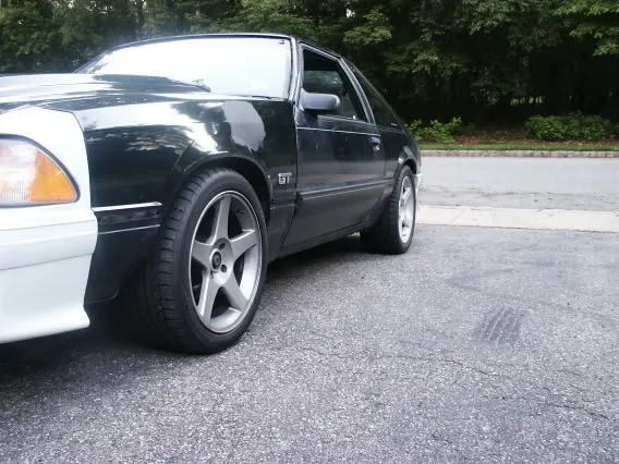

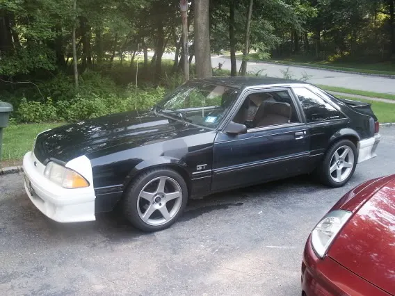

The UPS guy brought me some 17x9 chrome 03 cobra wheels today! On wednesday they're getting mounted to 235/45/17 bfgoodrich g-force sports and 275/40/17. Heres a few pics.
Those are gonna look sic with your car, although I think that a set of clear headlights would probably make a nice contrast with the wheels opposed to the smoked ones. Just my opinion..should look sweet though. You got the parts for a 5 lug conversion yet?
You will want to reconsider doing the 235's on the front, they look terrible on a 9" wheel. The rim will stick out and grind on any little curb you even get close too. Do a 255/40/17, you will like it much better, trust me. I can send you pics of my car with 255's on 9's and its barely wide enough, IMO. I love your car and have been waiting for you to get some rims, so I would hate to see you do the wrong ones.
I agree, 235s are way too small on a 9" wheel. When I had 17x9 cobra Rs on the front of my car I had 235s when I first got them. One particular cold morning the pressure in the tire got pretty low but since the wheel was quite a bit wider than the tire I couldn't tell. As I rounded a corner, not only did the tire go completely flat, it completely separate from the wheel and tore up the edge of my rim. I promtly bought 255s for it so that if I ever got a flat again the tire would stay seated to the wheel.

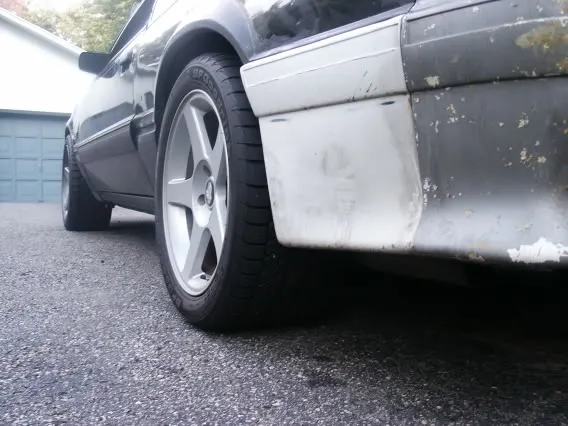

Here's some pics of my BFG G-Sports, 255/40's up front an 275/40's out back
