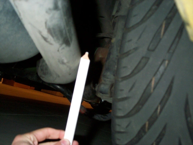

sweet looking, i was wondering if you had to run any wheel spacers, and do you think a bfg drag radial 325/50/15 would fit alright. thanks.....
I didn't have to run any spacers for my setup, but there's only 1/2" between the inside of the tire and the exhaust tailpipe. I'd imagine a 325/50/15 might need a spacer to keep it front touching the tailpipes and you might risk rubbing on the fender. If you have dumps, then you may not need a spacer.

hey kurgan, would you think that your setup would rub against my exhaust? I have magnapacks. Would spacers move the 295 tire out too much?
I don't know if it would rub up against your exhaust or not. I have 2.5" flow tubes and with the 15x10 wheels having the 6.5" backspacing, my rear tire is about 1/2" away from rubbing the exhaust. If you were to get the same wheel and tire combination and used a spacer, it wouldn't look that great, and you might face an issue with rubbing on the fender. The 6.5" backspacing is important because it keeps the tire from sticking out beyond the fender flare on our cars.
