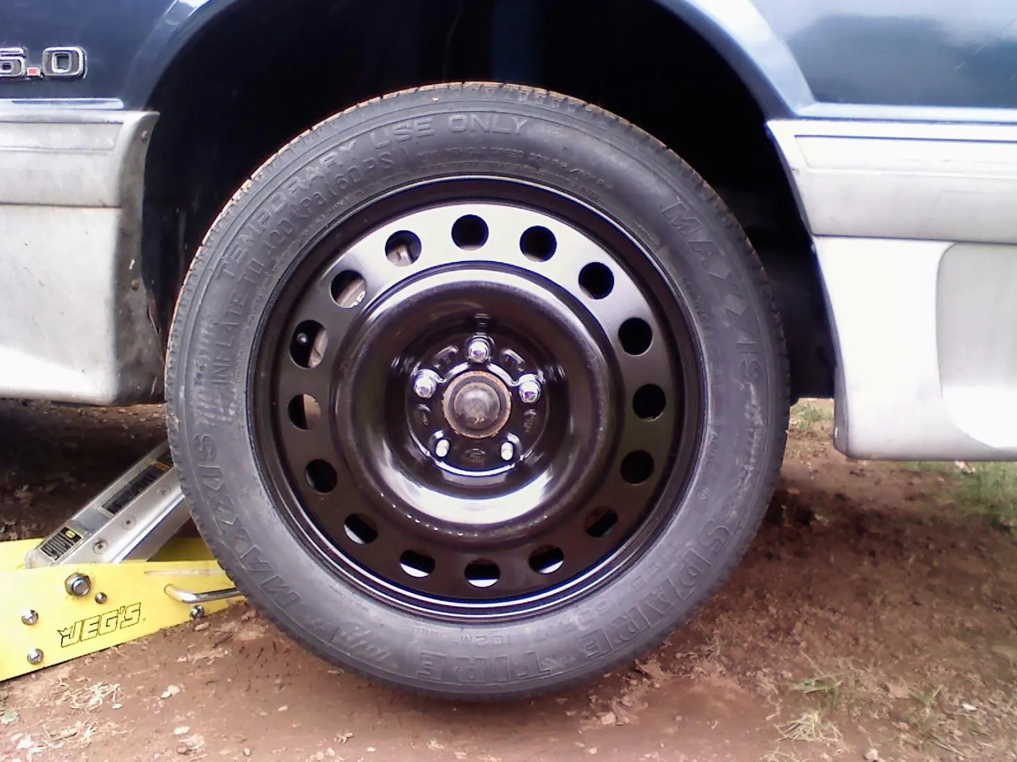

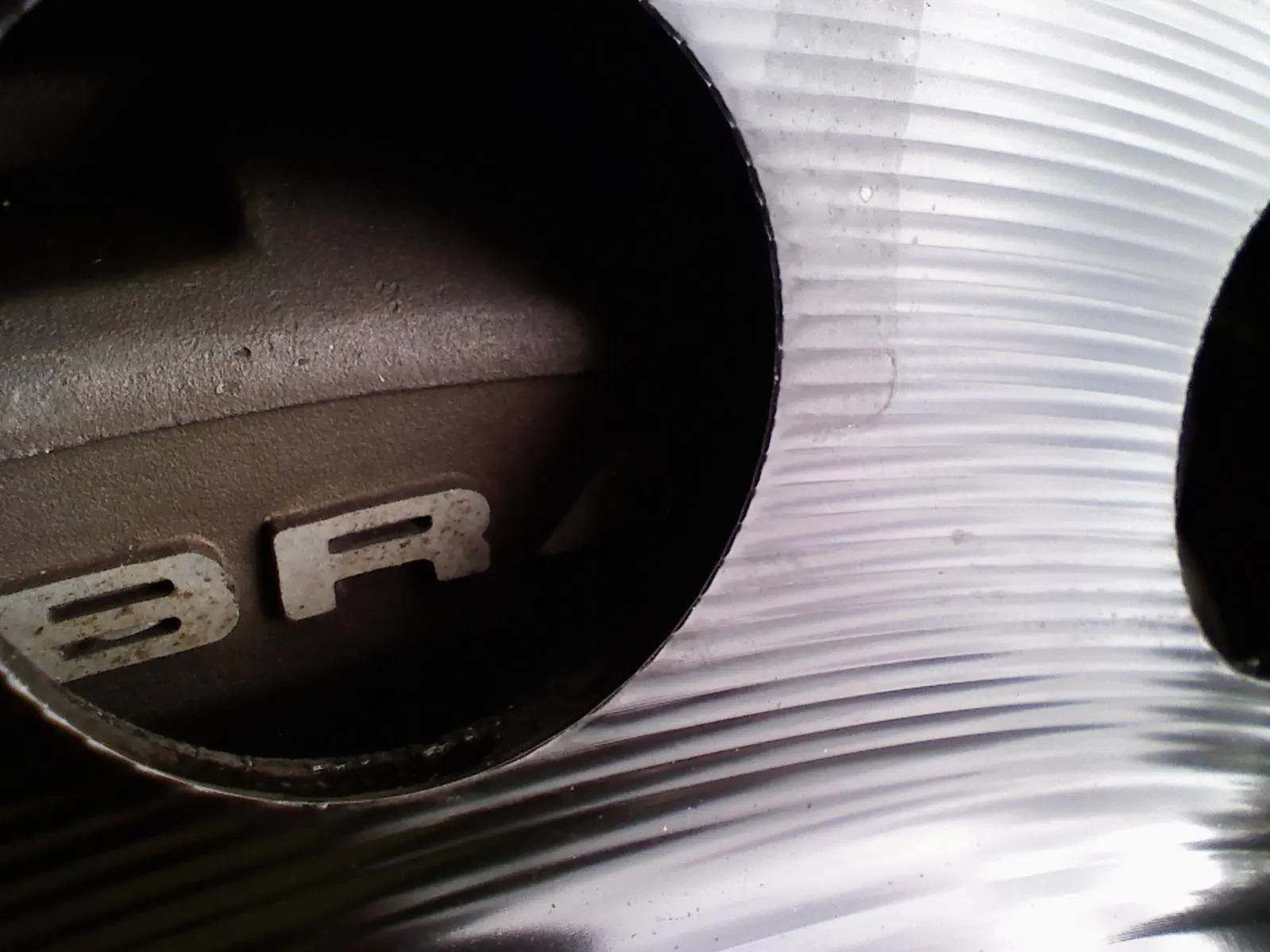

I finally got the 05+ gt spare, which looks to be a 17x5. It fits over the front brakes just barely. I actually thought it was going to rub, but i drove it around to be sure and there was no rubs. The only problem with this spare is it is slightly too large for the spare tire well, it sticks up maybe 1/2 an inch, i think the 17x4 spare may be the best option, it looks like both were offered at some point, mine even has the part numbers for both on the front.
