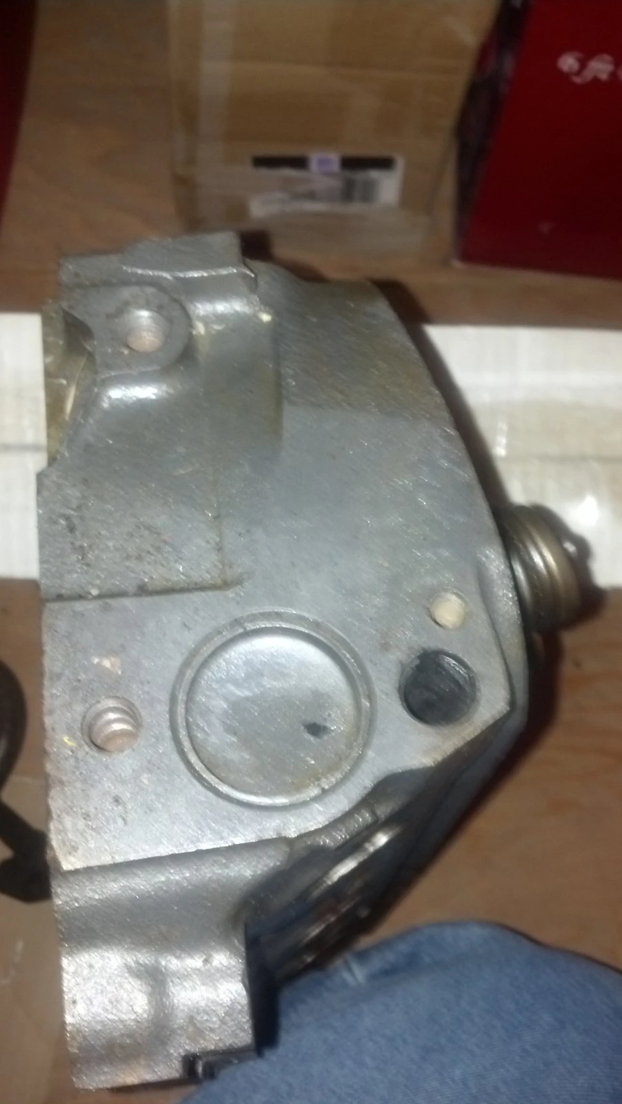

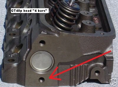

GT40 Head is leaking out of the hole pictured. It's at the back on the drivers side. It's leaking coolant as fast as I fill it with coolant. I've looked for cut-aways or diagrams for the GT40 heads and passages to find out whether or not this hole was at one time plugged and part of the water jacket? Or if it should be AIR only and my head is cracked internally? I've done a lot of research and found only comments about the larger freeze plug doing this.. please help me solve this problem. I've found threaded plugs to thread in. But would like to know why I'm suddenly leaking coolant when it never has before..??

Are you using Gt 40 or GT40p heads? The P heads as far as I remember don't have a thermactor port on the back of the head as they use an external EGR system?
It may not be the therm actor hole. As stated, I'm unaware of what it is for. That is why I provided a picture with an arrow pointing to the hole in question.

Thermactor ports are a large (3/4"?) threaded hole with a 1/4" hole next to it. It is also nearer the top, outside corner. If it was an AIR hole leaking coolant, coolant would be going out the exhaust too.
pressurize the cooling system with the car off. See if you get water coming out of that hole- which is to mount the accesories. Those are 4 bar P heads that have an external EGR, so no thermactor ports. Good luck.
Thank you guys, I didn't know if it was plugged from the factory, and somehow a plug had come out. My thoughts were to plug it and do a coolant system pressure test and see if I end up with coolant anywhere else... or in the oil.
It certainly could be cracked, but I didn't want to say that and lead anyone that direction. I wanted to actually find out what the holes were for first. Weather here in IN has been rough this winter, 0-Teens* weather consistently.. (-45*) windchill at times and it was parked outside. We should hit 30*'s end of this week and it's like a heat wave! When sweatshirts / no jacket is comfortable in 30* weather... you know it's been too cold!
Update: I threaded a plug in that accessory hole today. Poured in more coolant... still pouring right back out.... A closer look showed it coming from the freeze plug, directly above the accessory hole. It was ever so slightly kicked out at the bottom. It was leaking down into the acc. hole and out of that, or so it appeared.
