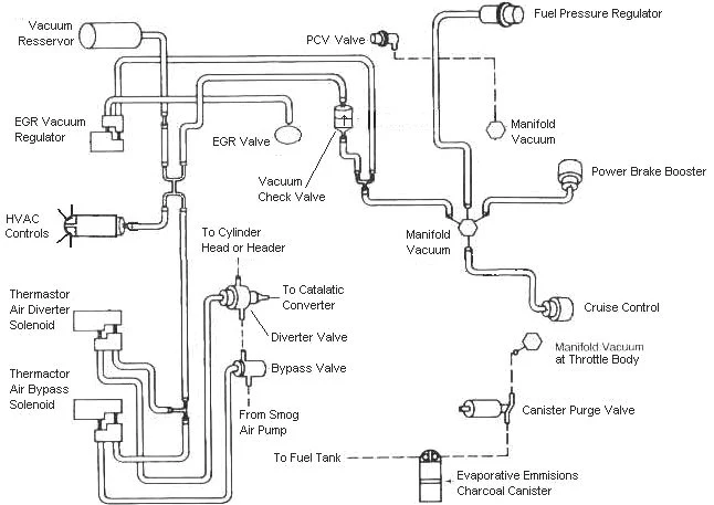

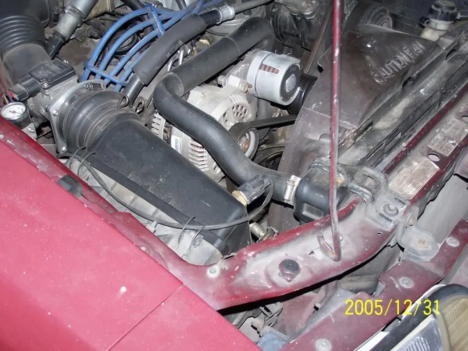

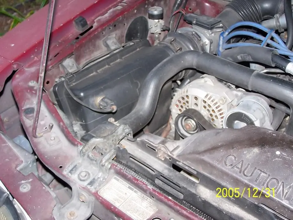

The vacuum lines you need are 1 small line for fuel pressure regulator, 1 small line for A/C,1 small line for EGR and another small line for the smog pump. One big line at the back goes to the vacuum tree for the power brake & A/C, one big line goes to the PVC valve. The other big line goes out the front for the carbon canister. In a pinch, one of the small lines can connect to the spare port on the vacuum tree. Cap or plug the remaining lines since they aren't needed.

Vacuum line connections:
One large vacuum line from the upper front goes to the carbon canister
One large vacuum line from the rear goes to the vacuum tree.
One small line in the front feeds the Smog pump solenoid control valves on the rear of the passenger side wheel well..
One small line in the rear goes to the fuel pressure regulator.
One small line in the rear goes to the EGR suction regulator.
One large line in the rear goes to the PVC valve.
Diagram courtesy of Tmoss & Stang&2birds - Typical Vacuum Routing for a Fox stang 5.0:
