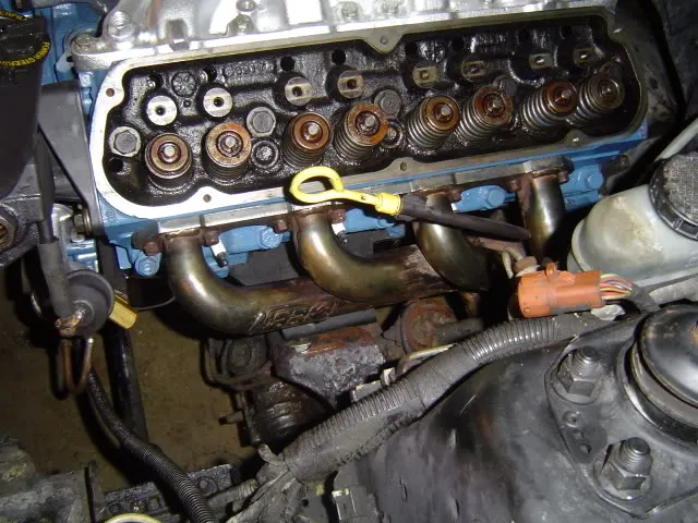

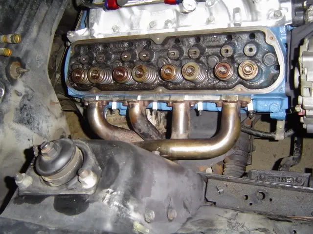

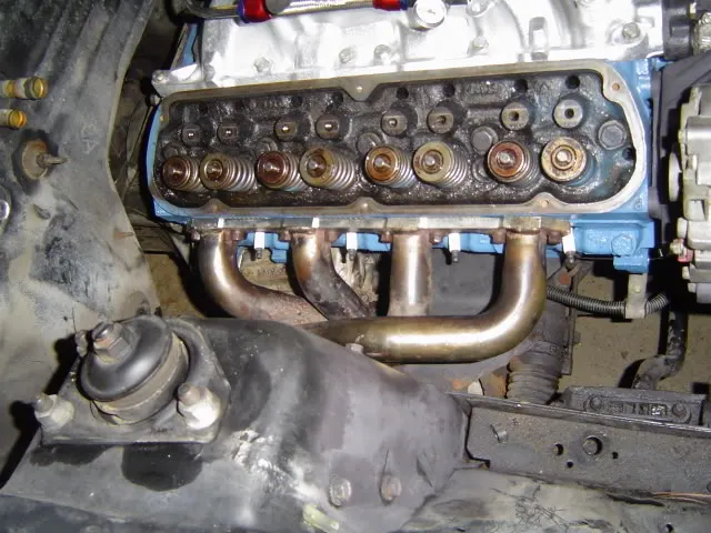

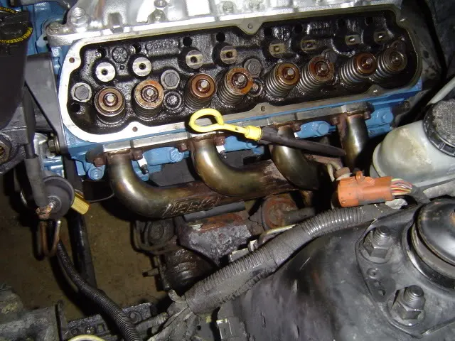

GT40P and 1 5/8" BBK longtubes will it work, pics?
well do you have the headers and the heads? if you do.. slide the exhaust ports out toward the side of your bench, bolt up the header and stick a spark plug in there.. see if they will clear or not
Here ya go:
You will have to cut down a plug socket and use a wrench on the end of it to get the plugs on cyl. 1,2, and 3, plus use 90* boots on the wires, but other than that, no probs.
Plug changes are still quicker than stock.
