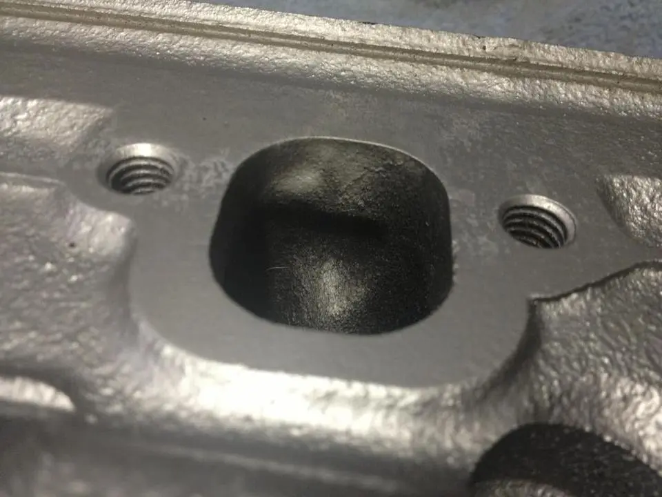

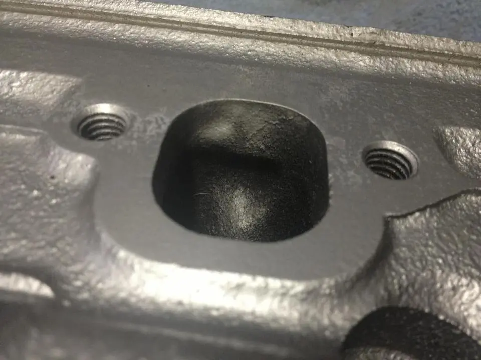

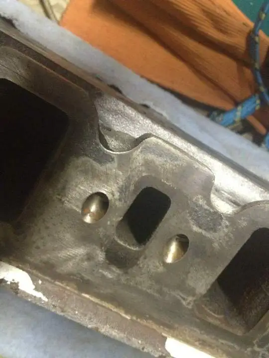

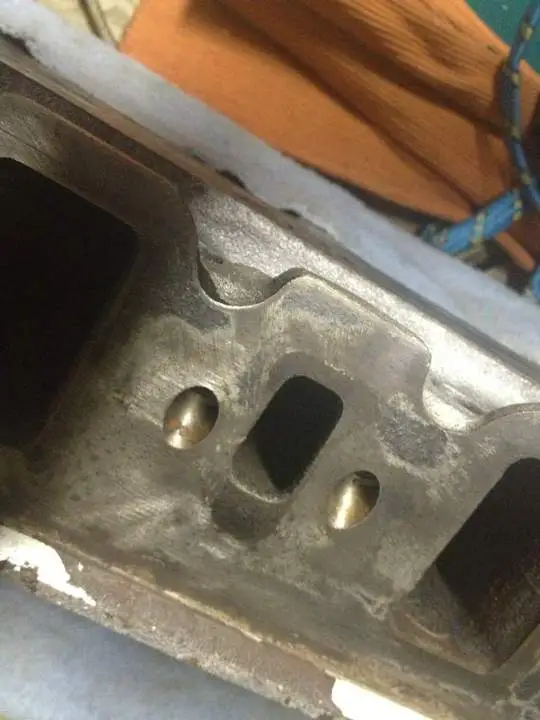

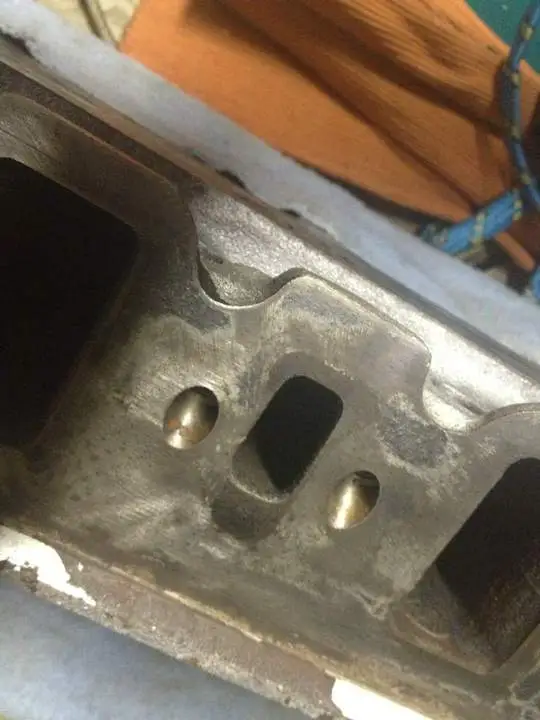

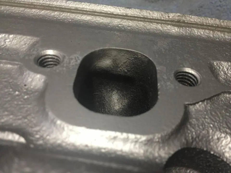

Ok took a peek at my heads.
EGR port is there. Connects to one of the two center cylinders. Tried to get pic of inside but can't do well on iPhone.
Therm actor ports are not drilled, but the bumps are there. Just not machined through.
Sent from my iPhone 4S using Tapatalk
