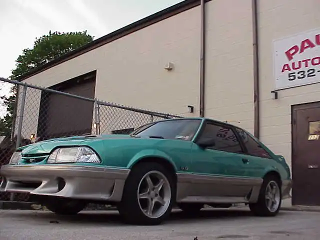

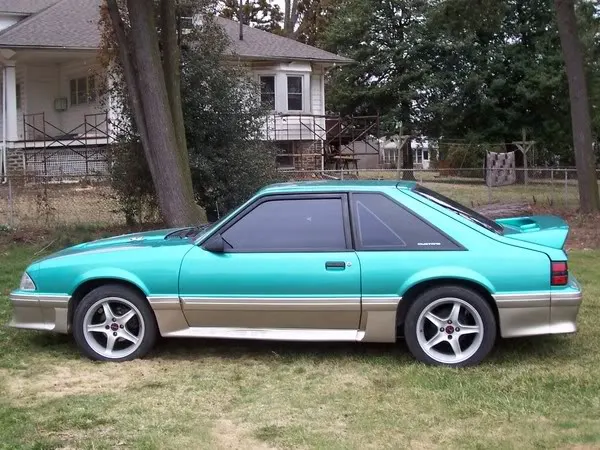

I dont know man, it wasn't a red car, it was a grey or white GT w/ pony wheels, yea it was at ATCO and I live in philly... drove all the way there just go check out mods of ppls cars, actually, i tend to like Cecil county dragway 2 to 1 over atco, just because of the set up and the openness, and I raced on atco track, and i didn't like the feel of it, very bumpy in the right lane by the christmas tree, i'll let you know what track i think is better when i race on cecil (won't say its better cuz haven't ran it yet) but it looks way cleaner and nicer... as a matter of fact, i'm gonna eat at the TGIFridays in deleware, and than i'll hop on south again go to cecil (w/ my girl lol) i drag her along w/ me -
I like the color of your car buddy, its awesome... heres mine, and good luck, i'm telling you, go w/ either the thumper combo, or the eddy heads, cuz they such a good deal, and alot of ppl overlook them rightn ow cuz of the twisted wedge and afr "rage, phase" - you have a notch, i'm sure your car w/ a thumper combo or eddy would almost definately be in the 12's depending on your driving skills, good luck pal!!

Man I love the color on that GT! What's it called? I dont remember that being an OEM color. Is it?
Yes, it's oem, i asked for 92, lx, calypso green, and had a gallon mixed. Only used i think 3 coats of paint, and 2 coats of clear, but my clear is as shiny if not shinier than some peoples car that claim to have 10 coats of clear, and this is because I did it myself, and chances are, there really isn't 10 coats of clear, its not how many coats of clear, it's how you work the clear when it's done.... anyway - majorly off topic... but yea it's facotry calypso.. i think the paint code may be PM or something like that, I think it's the same color as your car, w/ diff lighting.. thanks man
