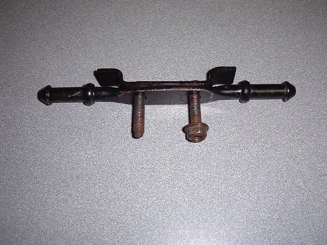

Got all the old exhaust out finally. The POS bracket that holds the h-pipe to the tranny crossmember was the worst part of all. Took a lot of patience, about 1 hour of time and vice grips to remove the nuts from the stud on the bracket. I need to find a new one in the morning or have an exhaust shop remove the studs so I can put normal hardware on it. The manifold to h-pipe nuts turned out to be a breeze. Now I just gotta get all the new stuff in. :flag:
Got the bracket fixed at a muffler shop for $5. New X-pipe and magnapack catback are in and sound badazz. A lot more top end pull and smooth revving throughout the RPM range with this combo compared the stock H and dumped flowmasters. The Magnapacks are loud but aren't as loud as I expected, but they sound awesome. I'm officially done with flowmaster, they sounded good on by 94 GT with 5.0 but sorry I wasted the money putting them on the cobra. The flowmasters were on my car a 1 1/2 years in Texas and already looked like hell.
