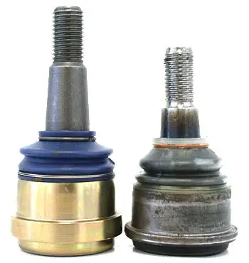

Steeda's X2 Balljoint changes the geometry on the Mustang by raising the spindle relative to the balljoint pivot-point. Here is a picture of the stock on right and Steeda X2 on the left.
They come with spacer rings to put under the springs if you do not want the car to be any lower than it was before the install of the X2's.

yes, however you are missing the point. the ball joint replacements are not made to change the ride height... yes , the spindle location will be different, as you need to correct that area of the geometric equasion once you are lowered passed a certain point, and the spacers are there to adjust to whatever height your car is currently... they are not there to change ride height, and i dont believe they do... springs drop the height, and once you get low enough the replacement ball joints fix a single problem with going lower, they by themselves, do nothing for ride height, so would not realy do anything for the current issue of not being low enough.

Yes, their design intent is not to lower a car, but the result of their design does, it is a fact if the included spacer plates are left out the result is a lower ride height.
