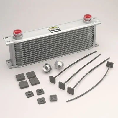

I think I'm going to go with this cooler from Earl's. It is a plate-type, compact, and I think the 4"x9"x2" thick core will be plenty for street use in this car. It's got to be at least as functional as the air/water type I removed from the engine. It also uses -10AN fittings which what I have on the rest of the oil system (remote filter).
I like that one too as it's pretty true to the Cobra style with the topside connections:
