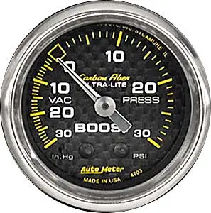

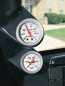

here is the pod...

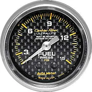

here are the gauges...
not my favorite or anything, but cheap and do what they have to do. I really don't want to get them, but they are kinda needed with my mods.
