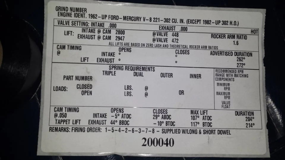

1965 289 that we freshly rebuilt. Bored .40 over.
Mild flat tappet cam I posted the cam spec sheet. Apparently its unusual specs.

with only .472 exhaust valve lift, and 214 degrees duration, you shouldnt have any PV clearance issues even with the 185 heads. the intake just doesnt have enough lift to be an issue even with a 2.02 intake valve.
and by the way, the cam you selected isnt unusual, in fact there are many cam grinders that have similar grinds in their books.
