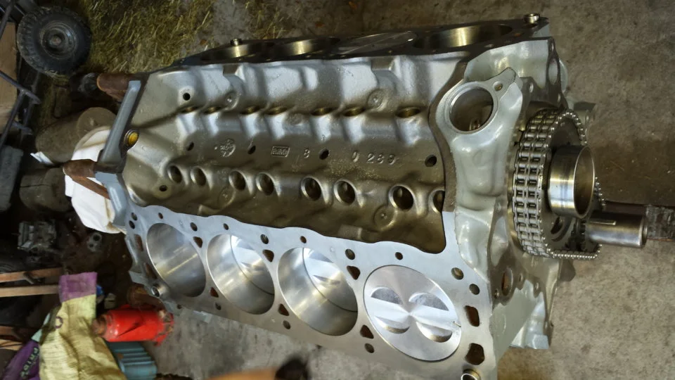

are your pistons flat top or dishee.
either way you need to mill the eddy heads to 56 cc's otherwise your compression will be low.
just found out my pistons are flat. I thought valve relief and dished were the same thing
ok, cool but if you win the lotto and want the most hp, buy the afr's because the extra 2 cc smaller chamber will help and the extra flow won't hurt and will still acomodate a little bigger cam later. your flat tops still have 4 valve reliefs instead of 2 so those eat up some compression.

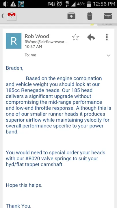

This sound okay? I've heard bad things about reps. Just checking. I may save up and just be patient not sure yet

i don't understand what your question is.
i told you that 165 afrs are slightly bigger than what you need but will work killer. if you want to loose bottom end performance and not gain any top end perf, then buy the huge 185's that are run on 360 hp or more engines.
hes a rep making minimum wage. i'm an engine builder.

I believe you! I was recommended to ask afr and what he said didn't sound right so I had to check. Thanks again!
