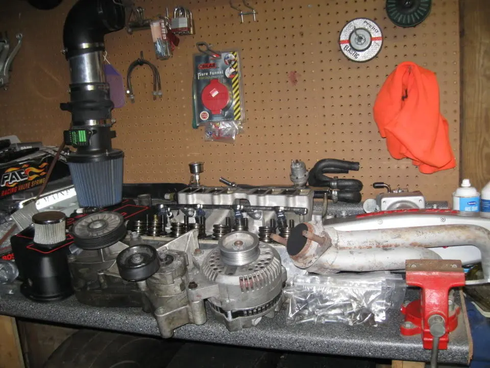

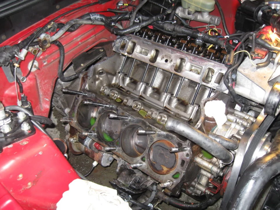

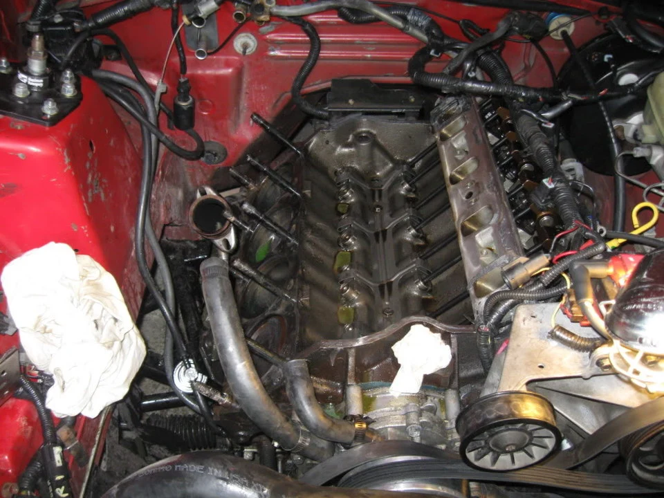

This is the progress as of the end of day 2.
