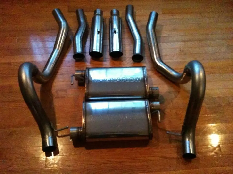

I called Magnaflow and asked them about going from 3" down to a 2.5" catback system and they said all that is causes is more back pressure and increases low end Tq. If I were to stay 3" all the way through it would have less back pressure and move that TQ higher in the RPM range. They said it is not detrimental or anything like that just a matter of more or less back pressure and where the TQ is seen in the RPM range.

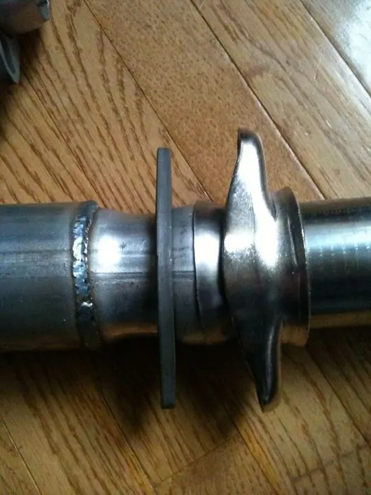

Went to one exhaust shop today and had the very ends of the prochamber (where it flares out) cut off. Looks as though I'll have to band clamp the prochamber to the long tubes with no cats on it and then bring it to a shop and have the cats welded on. They cant do it off the car. I also asked about getting the 2.5" flow tubes expanded out to 3" so it would mate up to the prochamber and they said they could not do it but there is another exhaust shop in town that may be able to. Its just a matter of having a large enough die. I was not able to make it there before they closed but I sent them an e-mail.
last piece is finally here.

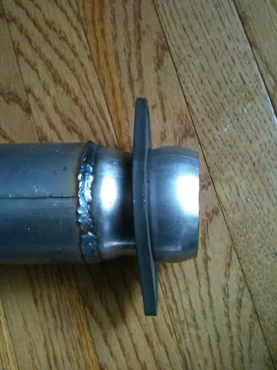

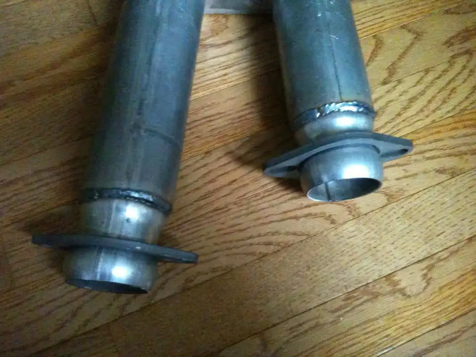

Oil change done filled with Amsoil, Coolant filled in the radiator (will prob need more once its started and its sucked through the system) Power Steering pump filled, battery put back in and it was nice to see that everything was still working electronically. Picking up the Prochamber from the exhaust shop on Friday where they modified it so that it will accept the 2.5" flow tubes. Entire exhaust install and start up date is this coming saturday, great weather expected as well so I hope I get to enjoy some of it while taking a quick drive in the Cobra
Picked the pro chamber up today with the modification done so that the 2.5 cat back will bolt up to the 3" pro chamber. I'm really happy with how it came out, they did a great job with some great welds.
